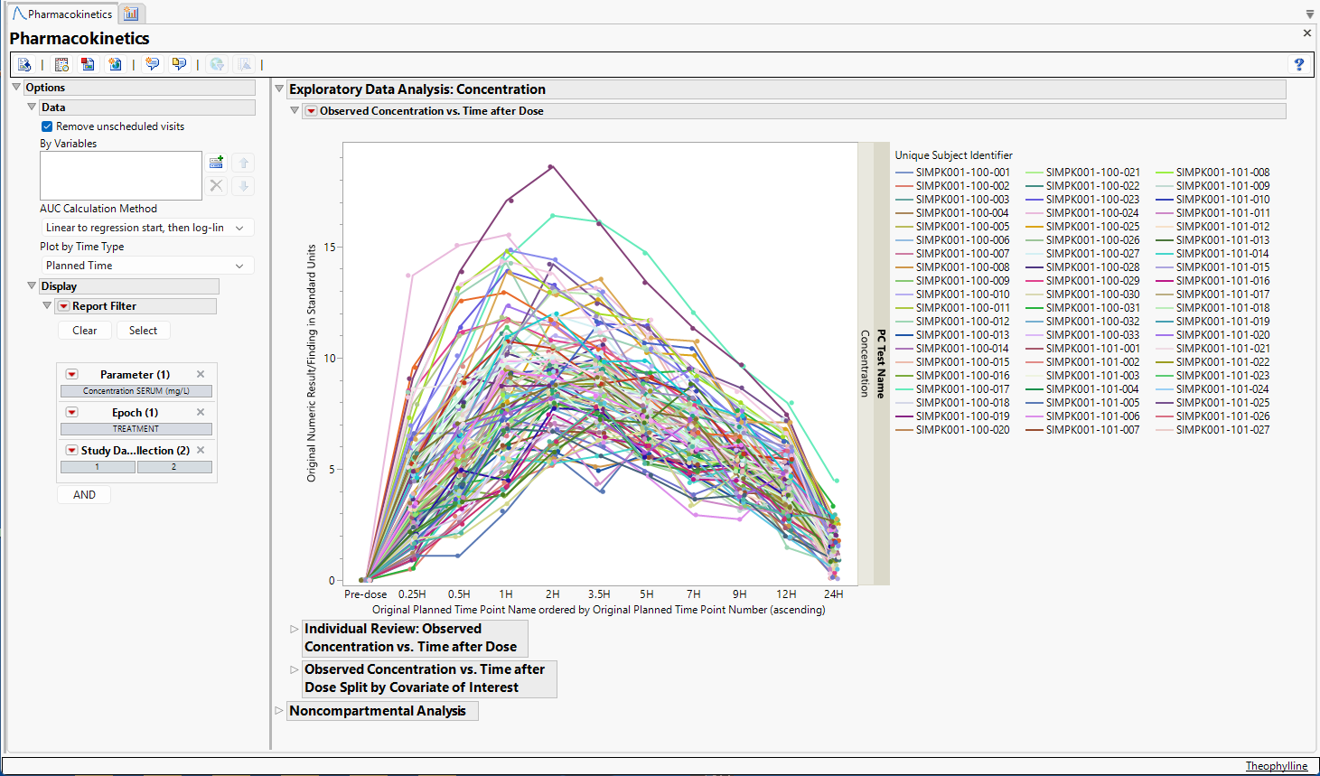

Running the Pharmacokinetics report for Theophylline using default settings generates the report shown below.
Output from the report is organized into sections. Each section contains one or more plots, data panels, data filters, or other elements that facilitate your analysis.
The Report contains the following elements:

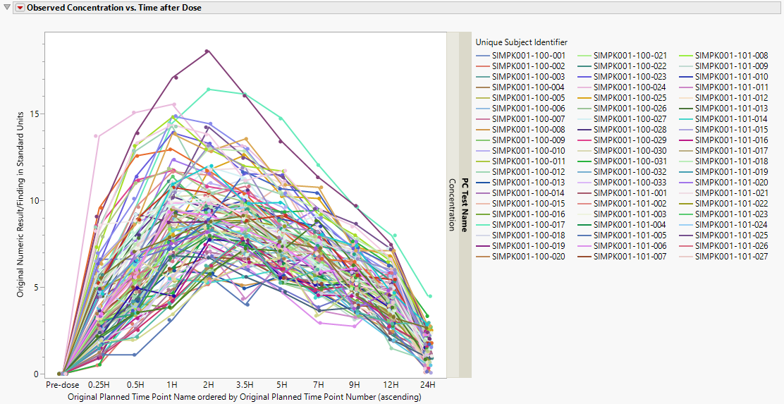

Observed Concentration vs. Time after Dose
This plot displays observed concentrations for the Theophylline data by the planned time after dose for each patient in the trial.

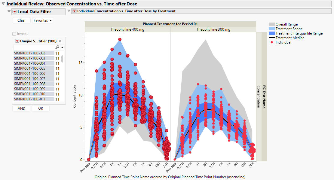

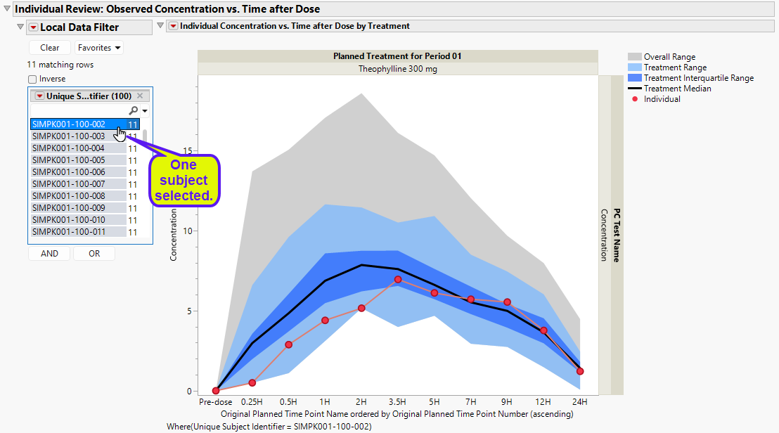

Individual Review - Observed Concentration vs Time after Dose
This plot displays concentration data by treatment for each patient (red dots), with shaded areas describing the overall range of concentration data (gray), the treatment-specific range of concentration data (light blue), and the treatment-specific interquartile range of concentration data (dark blue), along with the treatment-specific median concentration curve (black) and the individual concentration curve (red), which summarizes the mean concentration when more than one patient is presented.
The Local Data Filter can be used to subset to an individual patient to view their particular pk concentration profile. This view makes it possible to assess the individual’s pharmacokinetics in the context of the entire treatment arm as well as across all patients.

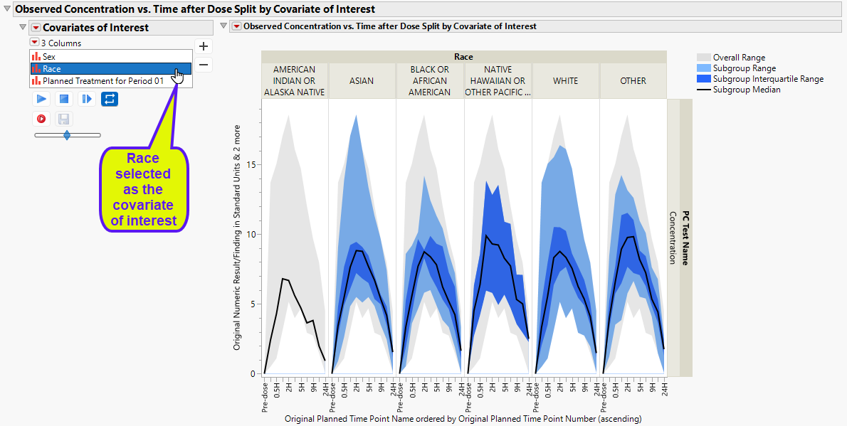

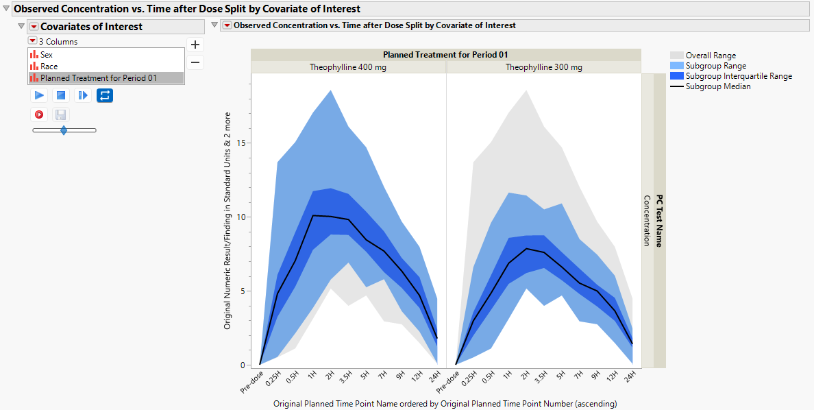

Observed Concentration vs. Time after Dose Split by Covariate of Interest
Concentration data can be further summarized by treatment group (default). In the figure below, the subgroup-specific range of concentration data (light blue), and the subgroup-specific interquartile range of concentration data (dark blue) are presented, along with the subgroup-specific median concentration curve (black).
Concentration data can be further summarized and presented by demographic subgroups, such as race.

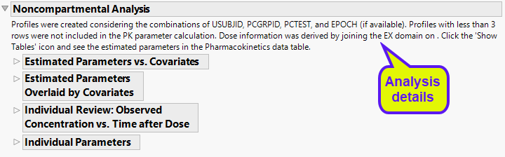

Noncompartmental Analysis
Non-compartmental analysis (NCA), like non-parametric statistical analyses, applies a minimal number of assumptions to the underlying PK model. For a given patient, their concentration data are plotted across time and estimates of PK parameters are derived.
There are numerous plots (shown below) to assess the computed parameters of the non-compartmental analysis.

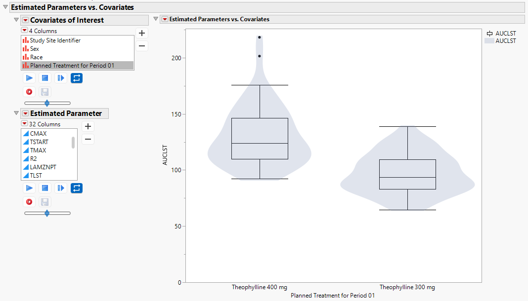

Estimated Parameters vs. Covariates
The box-plot with an overlaid violin plot shows the distribution of observed parameters by key covariates.

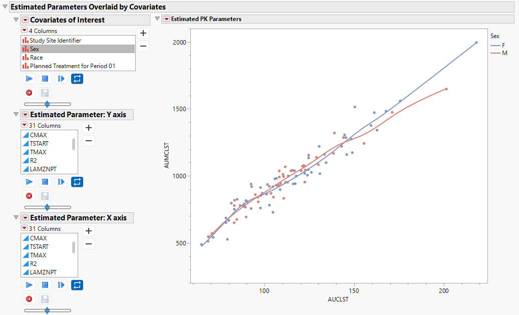

Estimated Parameters Overlaid by Covariates
The scatter plot enables you to view pairs of PK parameters with non-parametric curves to assess their bivariate relationship.

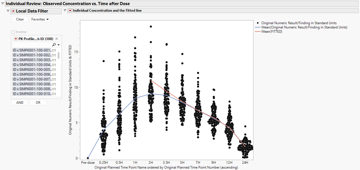

Individual Review: Observed Concentrations s. Time after Dose
The plot below presents concentrations with a curve fitted to the mean concentration at each time point (blue) and a curve fitted to the mean predicted concentration based on a linear fit over the elimination phase of the curve (red).

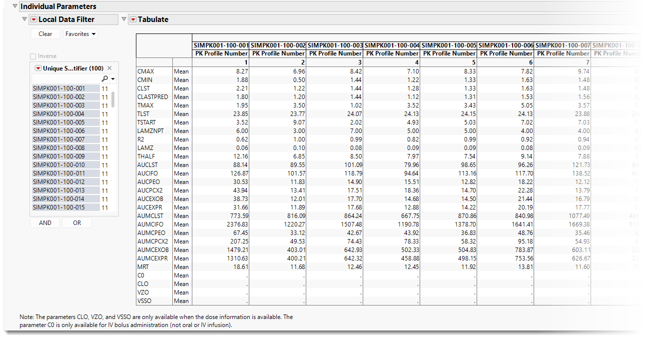

Individual Parameters
The following label lists computed parameters for each patient.
Computed parameters include the following:
| 1. | CMax (CMAX): The maximum observed concentration for a patient. |
| 2. | CMin (CMIN): The minimum observed non-zero concentration for a patient. |
| 3. | CLast (CLST): The last measurable concentration for a patient. |
| 4. | ĈLast (PREDCN): The last measurable predicted concentration for a patient. This is observable when subset to an individual patient. |
| 5. | TMax (TMAX): The time of the maximum observed concentration for a patient. |
| 6. | TLast (TLST): The time of the last measurable concentration for a patient. |
| 7. | TStart (TSTART): Observed time where the “start of regression” occurs. This is observable when subset to an individual patient. |
| 8. | λZN (LAMZNPT): The number of points included in the regression of the elimination constant. This is observable when subset to an individual patient. |
| 9. | R2 (RSQUARE): The maximum R2 from the best fitting regression line to determine the elimination constant. |
| 10. | λZ (LAMZ): the elimination constant, which is the rate at which a drug is eliminated from the body. |
| 11. | T1⁄2 (THALF): the half-life, which is the time required for the drug concentration to decrease by half. |
| 12. | AUCLast(AUCLST): The area under the curve, computed from time 0 to TLast, the last observable time point, which represents the total drug exposure in the body over time. |
| 13. | AUC∞ (AUCIFO): The area under the curve, computed from time 0 to ∞. |
| 14. | AUCPEO: The percentage of AUC∞ which is extrapolated i.e., (AUC∞-AUCLast)/AUC∞ × 100. |
| 15. | AUCPCX2: The percent of AUC∞ which is extrapolated relative to AUCLast, i.e., (AUC∞-AUCLast)/AUCLast × 100. |
| 16. | AUC(Last, ∞) (AUCEXOB): extrapolated AUC, from time TLast to ∞. |
| 17. | AUC(Last, ∞) (AUCEXPR): predicted extrapolated AUC, from time TLast to ∞. |
| 18. | AUMCLast (AUMCLST): The area under the first moment curve, from time 0 to TLast, the last observable time point. |
| 19. | AUMC∞ (AUMCIFO): The area under the first moment curve, computed from time 0 to ∞. |
| 20. | AUMCPEO: The percent of AUMC∞ which is extrapolated, i.e., (AUMC∞-AUMCLast)/AUMC∞ × 100. |
| 21. | AUMCPCX2: The percent of AUMC∞ which is extrapolated relative to AUMCLast , i.e., (AUMC∞-AUMCLast)/AUMCLast × 100. |
| 22. | AUMC(Last, ∞) (AUMCEXOB): extrapolated AUMC, from time TLast to ∞. |
| 23. | AUMC(Last, ∞) (AUMCEXPR): predicted extrapolated AUMC, from time TLast to ∞. |
| 24. | Mean Residence Time (MRT): represents the average time a drug molecule spends in the body. |
| 25. | Parameters that are available if drug exposure is available from an EX domain |
a. C0 (C0): the initial or extrapolated concentration at time 0 following an
intravenous bolus injection.
b. Plasma Clearance (CLO): the volume of blood or plasma cleared of a drug per
unit of time.
c. Volume of Distribution (VZO): the apparent volume of body fluid into which a
drug is distributed.
d. Volume Steady State (VSSO): the apparent volume of body fluid into which a
drug is distributed at steady state, which is the time at which the rate of drug
administration and elimination are equal.
