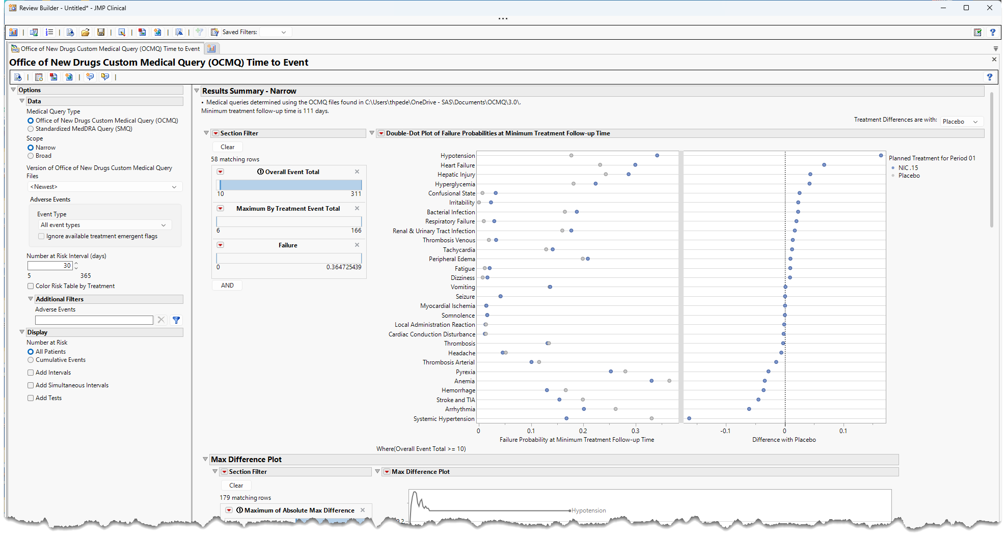

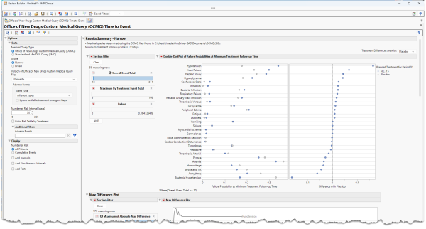

Running this report with the Nicardipine sample setting generates the tabbed Results shown below (click image to enlarge). Output from the report is organized into sections. Each section contains one or more plots, data panels, data filters, or other elements that facilitate your analysis.
The Medical Query Time to Events report generates analyses for studies with one or more treatment arms and computes treatment differences between all treatments for studies with two or more treatment arms.
The Report contains the following elements:
Results Summary

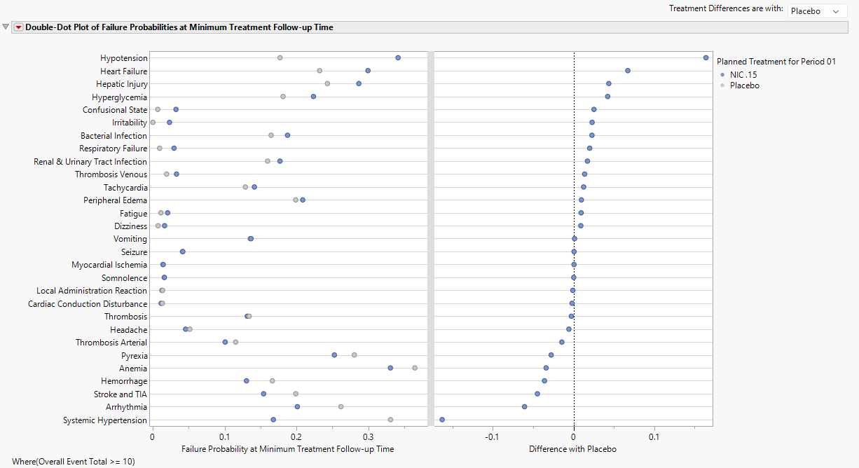

Double-Dot Plot
For studies with two or more treatment arms, differences between the treatment arms are compared at the minimum of the maximum follow-up times for the treatments. Here, the minimum follow-up time is 111 days.
This plot (click image to enlarge) is a modification to the more common dot-forest plot that is provided in other reports, as confidence intervals between the difference in probabilities estimated from two Kaplan-Meier curves are generally not available. The left panel presents the probability of a patient experiencing an event at the end of the study (here, 125 days). The right panel presents the difference in probabilities between the two treatments (here, Nicardipine minus Placebo, though this can be modified using the Treatment Differences are With selector). The y-axis is sorted so that events with greatest risk for Nicardipine are at the top of the figure with those with greatest risk on placebo are on the bottom. This highlights events that may be of interest to examine further. Note that for a single arm study, a dot-forest is provided with 95% confidence intervals provided around the individual estimate of event probability.
The limitation of the dot-forest plot, however, is that it only communicates the risk between treatments at a single point in time. For two or more treatments, an alternative to screen events across the entirety of follow-up, the max difference plot, shown below, can be utilized.

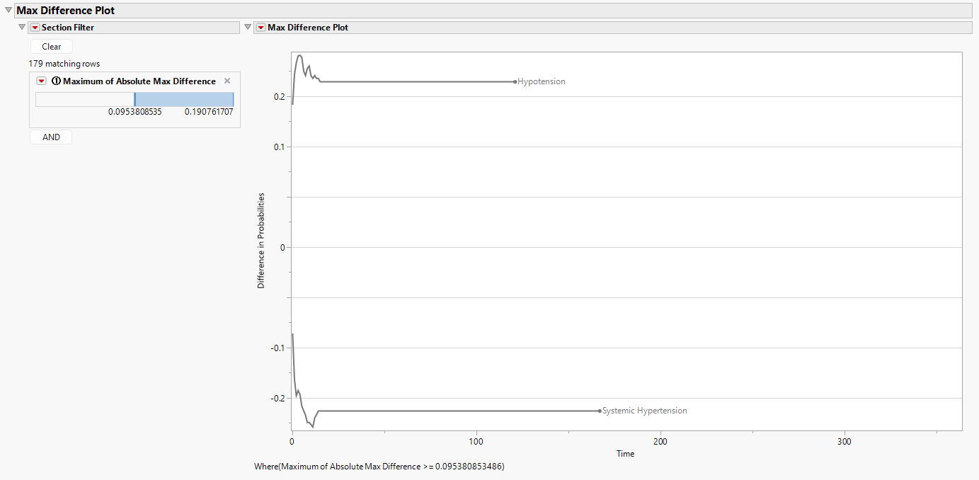

Max Difference Plot
This plot (click image to enlarge) computes the difference in Kaplan-Meier curves across the duration of follow up. When more than 2 treatments are available, the difference between the maximum probability and the minimum probability are summarized. For two treatments, the direction of the treatment differences are considered to show which of the two treatments has greater risk. For example, the above figure shows greater risk for nicardipine for hypotension, while placebo shows elevated risk for hypertension. Note that this plot is filtered to those events were limited to those with at least a difference of 9.57% observed at least once along follow up.

The remaining plots are specific to an individual MQ which can be selected by the Data Filter. By default, the event at the top of the double-dot plot is selected (here, phlebitis). Event plots are presented below (click image to enlarge).
Event Plots

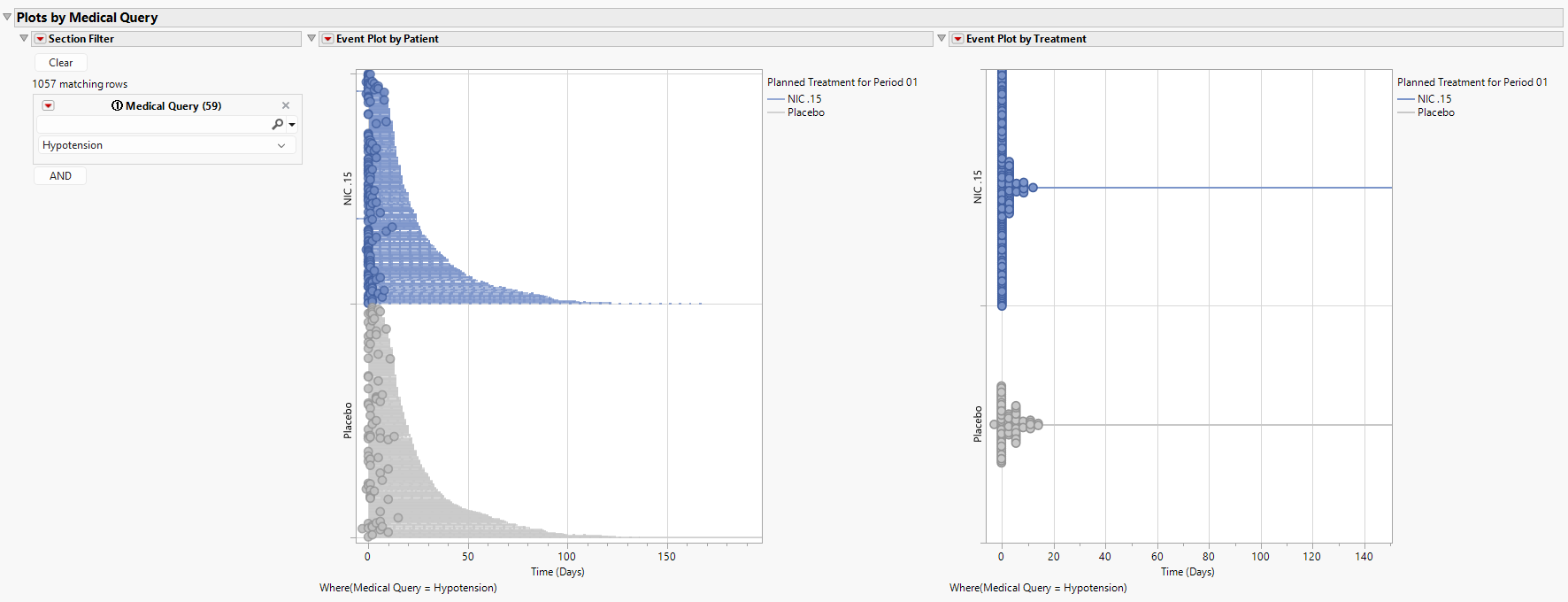

The plot on the left is a patient-level event plot which summarizes the follow-up for each patient with the first event highlighted on the plot. If multiple events were experienced on that same date, this would be denoted by differing bubble size. Though difficult to see for all patients, once a patient experiences an event becomes dashed so that it is easier to distinguish follow up that occurs after the first event. This helps the user determine whether particular events lead to patient discontinuation after the first event. The right plot is a treatment-level event plot where all events are presented along a line which represents the maximum follow up experienced on the treatment arm. As visible from either plot, patients experience their first phlebitis event within 15 days, and the nicardipine arm had far more patients experience events.

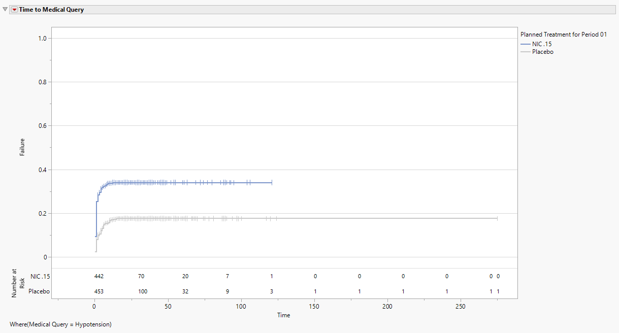

Time to Medical Query
This plot (click image to enlarge) is a failure-type Kaplan-Meier plot, which starts at 0 (no one has the event) with increasing probability to communicate the cumulative proportion of patients who have experienced a phlebitis event. Based on the tests and narrow confidence intervals, one can conclude there is a difference in phlebitis events between the two treatments.
The Number at Risk table, displayed at the bottom of the figure when All Patients is selected using the Number at Risk display option, communicates the number of patients who have yet to have an event or be censored. When Cumulative Events is selected using the Number at Risk display option, the total number of patients with events up to and including a particular time are presented in the risk table, which has now been renamed Cumulative Events. Numbers are presented every 30 days and at the last day of follow up.

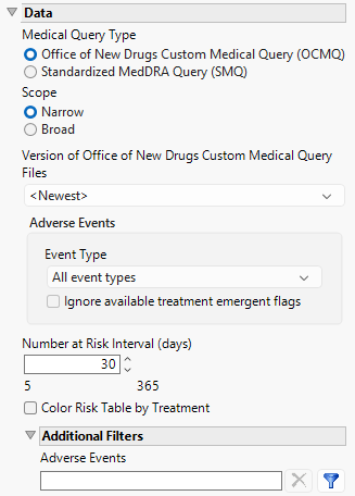

Data
Medical Query Type
This widget enables you to specify whether you are using the Office of New Drugs Custom Medical Queries (OCMQs) or standard medical queries (SMQs). OCMQs are used by default. Refer to Medical Query Type for more information. If SMQs are selected, then the AE dataset from the study will be joined with the MedDRA ASCII files to map each MQ to the associated medical queries. If the OCMQs are selected, then the AE dataset from the study will be joined with the OCMQ Excel file to map each MQ to the associated medical queries.
Scope
This option enables you to either broad- or narrow-scope medical queries in the analysis.
Version of Office of New Drugs Custom Medical Query Files/Version of Standardized Medical Query Files
Use this widget to specify the version of the Medical Query files to use in the analysis. Options include all of the Medical Query files stored in the Medical Query directory specified for your configuration. Choosing <Newest> uses the highest version folder in the displayed version list. It is not determined by file or folder modification timestamps. Refer to General File Paths for information about the location of this directory. This option is dependent on the medical query type specified above.
Event Type
Analysis can consider all events or only those that emerge at specific times before, during, or after the trial period. For example, selecting On treatment events as the Event Type includes only those events that occur on or after the first dose of study drug and at or before the last dose of drug (+ the offset for end of dosing).
Ignore available treatment emergent flags
If you choose to ignore available treatment emergent flags, the analysis includes all medical queries that occur on or after day 1 of the study.
Number at Risk Interval (days)
Enter the number of days comprising the block of time between study days where the number of subjects remaining in the study are reported.
Color Risk Table by Treatment
Use this option to color the numbers in the Risk Table by treatment.
Additional Filters - Adverse Events
This filter lets you restrict your analysis to only those subjects that meet specific criteria at the AE domain level. See Adverse Events for more information.
