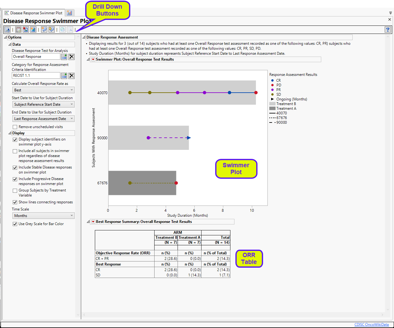

Running this report for a modified Nicardipine study using default settings with the exception that the Display Subject Identifiers and both the Include Stable Disease and Include Progressive Disease Response options were checked.
It contains the following elements:
Summary text
Summarizes the subjects plotted below.
One Swimmer Plot
The swimmer plots shows each subject’s response to treatment over the course of the study. Each bar represents one subject. Only those subjects who had at least one overall response assessment are plotted. The length of the bars correspond to the time each subject spent in the study and are colored by treatment. Reasons for leaving the study are not indicated. Response to the treatments are illustrated by the color of the dots, connecting lines, and arrows. These change color as treatment responses change. The dots indicate the time when the response was recorded. Arrows indicate ongoing response. This plot is a standard method for presenting these results.
Note: You can set your color preferences using theSet Value Order and Color in Studies... utility.
One Objective Response Rate (ORR) Summary table
This table lists the numbers of the subjects showing complete response (CR) and partial response (PR), as well as those with stable disease (SD) for each treatment. Subjects showing progressive disease (PD) as their best response would also be listed. The table also shows the overall response rate (CR + PR) for each treatment. Total subject counts are also displayed.
