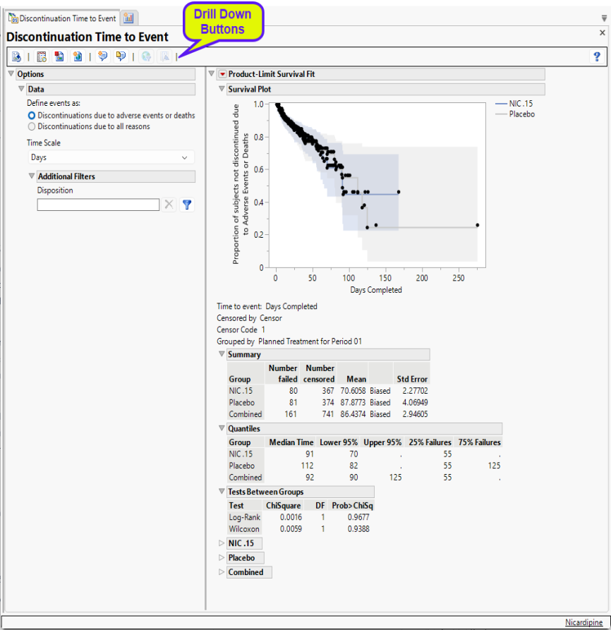

Report Results Description
Running this report for Nicardipine using default settings generates the tabbed Results shown below.

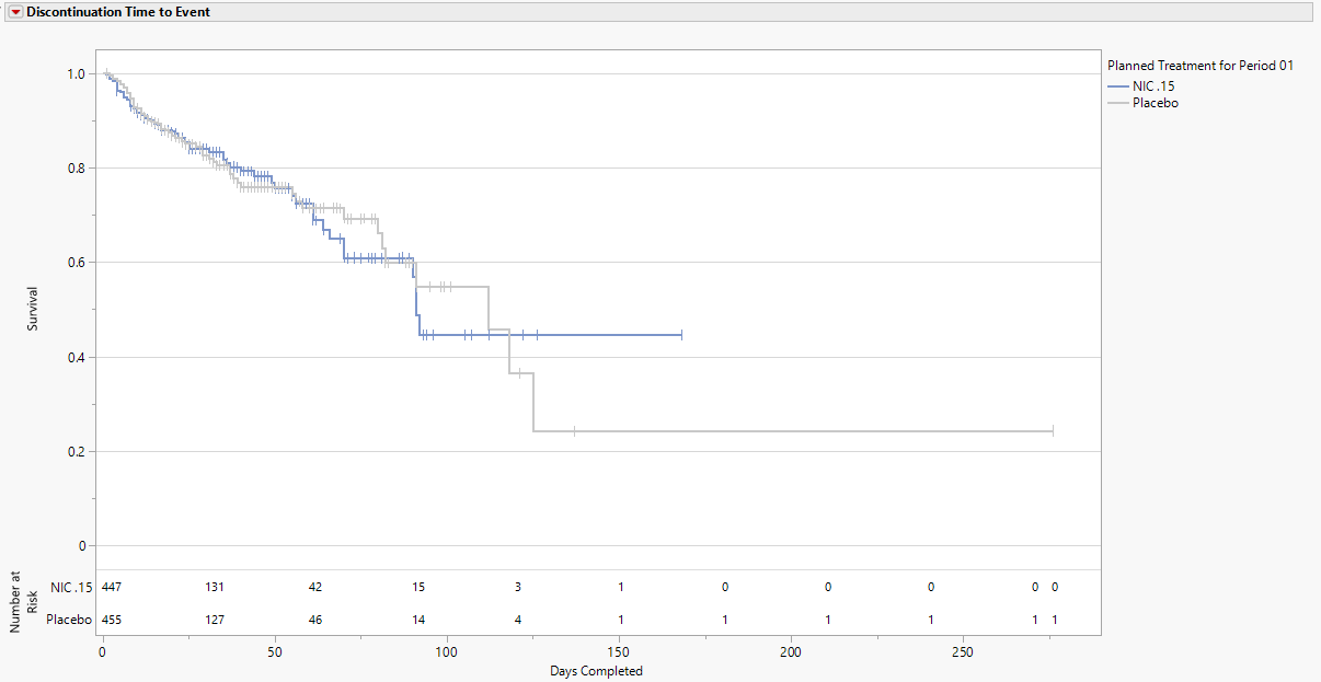

Discontinuation Time to Event
The Kaplan-Meier Survival Curve time-to-event analysis compares the time until discontinuation of individuals in each treatment arm in the study. Otherwise, subjects are censored when they complete the trial. You can define what constitutes a discontinuation using the Define events as: option in the Discontinuation Time to Event.
The Number at Risk table, displayed at the bottom of the figure when All Patients is selected using the Number at Risk display option, communicates the number of patients who have yet to have an event or be censored. When Cumulative Events is selected using the Number at Risk display option, the total number of patients with events up to and including a particular time are presented in the risk table, which has now been renamed Cumulative Events. Numbers are presented every 30 days and at the last day of follow up.

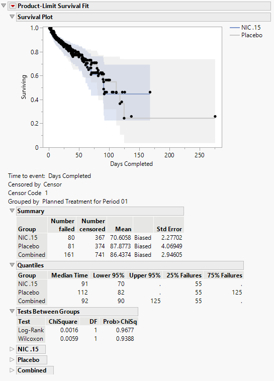

Product-Limit Survival Fit
Contains a Kaplan-Meier Survival Curve time-to-event analysis that compares the time until discontinuation of individuals in each treatment arm in the study. Otherwise, subjects are censored when they complete the trial. You can define what constitutes a discontinuation using the Define events as: option in the Discontinuation Time to Event.
