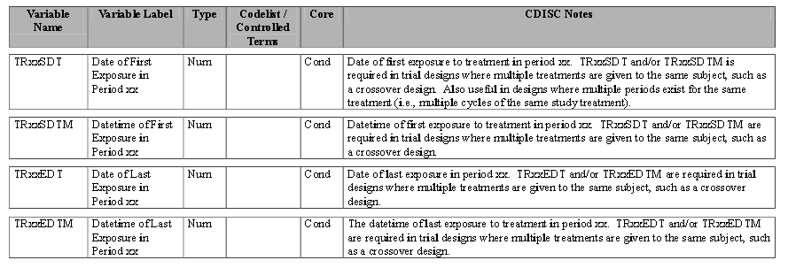

• Timing Variables (TRxxSDT or TRxxSDTM) and (TRxxEDT or TRxxEDTM): Dates or Date/Times in numeric format indicating the start and end dates respectively for each treatment period xx.
Variable Name Variable Label Type Codelist/ Controlled Terms Core CDISC Notes
TRxxSDT Date of First Exposure in Period xx Num   Cond Date of first exposure to treatment in period xx. TRxxSDT and/or TRxxSDTM is required in trial designs where multiple treatments are given to the same subject, such as a crossover design. Also useful in designs where multiple periods exist for the same treatment (i.e., multiple cycles of the same study treatment).
TRxxSDTM Datetime of First Exposure in Period xx Num   Cond Datetime of first exposure to treatment in period xx. TRxxSDT and/or TRxxSDTM are required in trial designs where multiple treatments are given to the same subject, such as a crossover design.
TRxxEDT Date of Last Exposure in Period xx Num   Cond Date of last exposure in period xx. TRxxEDT and/or TRxxEDTM are required in trial designs where multiple treatments are given to the same subject, such as a crossover design.
TRxxEDTM Datetime of Last Exposure in Period xx Num   Cond The datetime of last exposure to treatment in period xx. TRxxEDT and/or TRxxEDTM are required in trial designs where multiple treatments are given to the same subject, such as a crossover design.

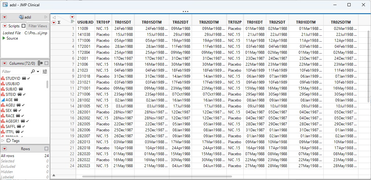

Currently crossover support is automatically detected and used if multiple TRTxxP or TRTxxA variables exist and the associated timing variables for the xx period exist and contain values. Those values might look like the values in the Nicardipine Crossover sample data set, shown below.
Note: For clarity, the majority of the adsl columns in the screen shot below have been hidden using the Cols > Hide/Unhide command.

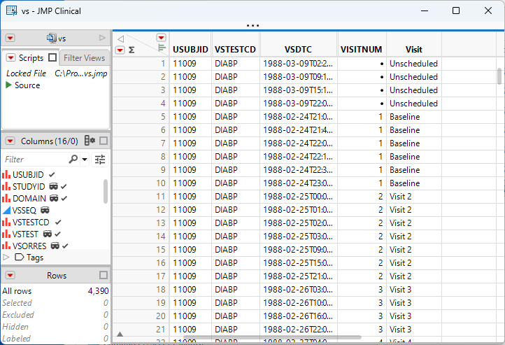

The SDTM data records for a subject can appear as shown in the portion of the VS domain (vs) for the Nicardipine Crossover sample data set, shown below.
Note: For clarity, some of the vs columns in the screen shot below have been hidden using the Cols > Hide/Unhide command.
Based on comparison of the VSDTC date/time (note that SDTM follows the ISO 8601 date/time standard) with the ADSL timing date/time, the subject records are assigned to the first treatment for Visits 1-6 and the second treatment period for Visits 7-14.
Similar analyses are done for events and intervention domains. In these domains, the timing comparisons for the record is based on the start date/time. For example, with the AE domain the AESDTC variable is used to assign the treatment period; indicating that the adverse event must START within the treatment period in order to be assigned that treatment value.

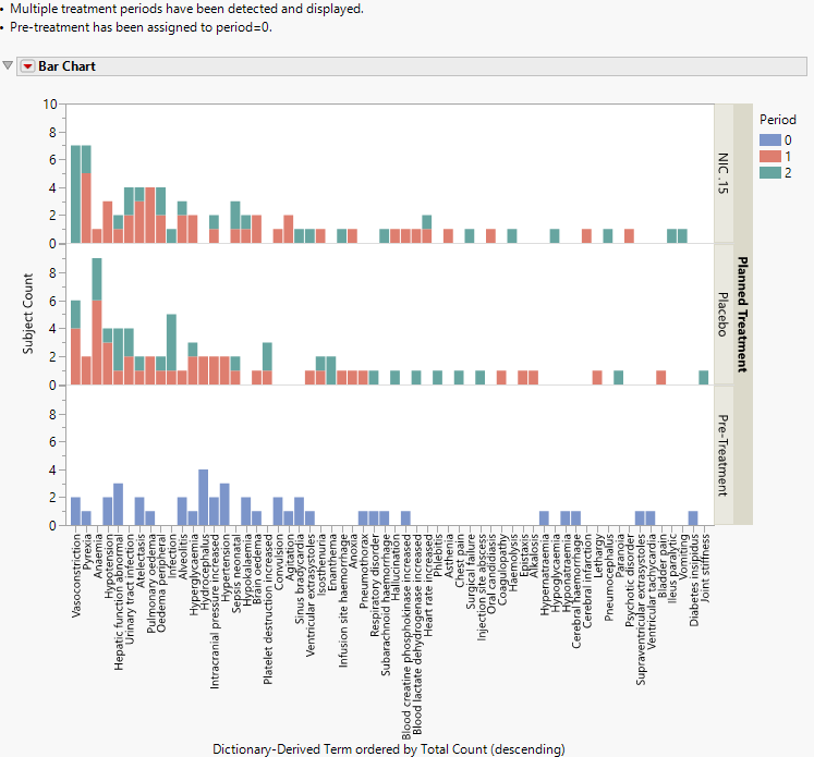

Adverse Events Distribution
When a crossover study is detected, the distribution results automatically categorizes adverse events by treatment period.
This view is similar for Interventions and other Events domains for distributions.
