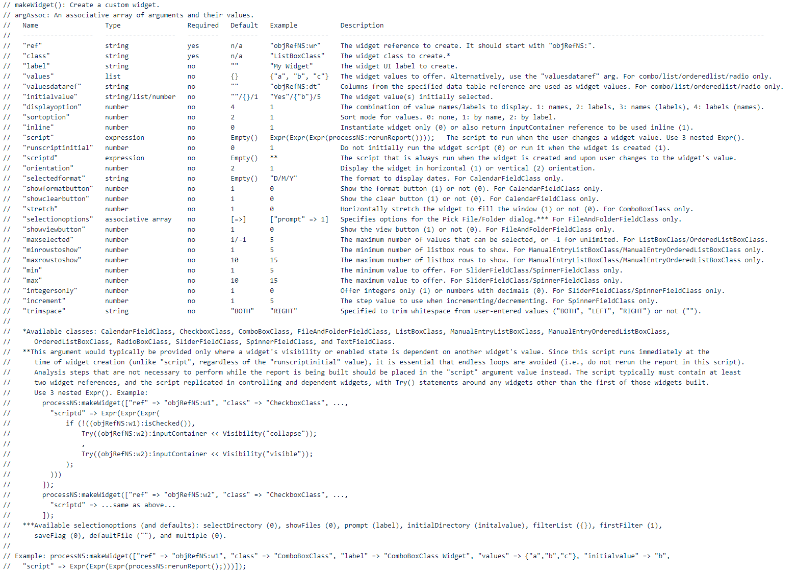

Custom public widgets are public widgets that can be heavily customized, with few built-in assumptions about data processing or dependencies. Custom widgets are not offered on Set Study Preferences.
To add custom public widgets to the report, use the processNS:makeWidget() function. You must pass one argument into the function that is an associative array of key-value pairs used for construction options.
To create a custom ComboBoxClass widget offering the values "a", "b" and "c", with "b" selected by default, and with the report rerun whenever the user changes a value, issue the following code within the data preparation section.
processNS:makeWidget(["ref" => "objRefNS:w1", "class" => "ComboBoxClass", "label" => "ComboBoxClass Widget", "values" => {"a","b","c"}, "initialvalue" => "b", "script" => Expr(Expr(Expr(processNS:rerunReport();)))]);
Later in the code, where you organize the collection of widgets to display on the report, you can reference this widget with the following:
// Place in the Options' "Data" outline; second argument 0 starts the outline as open, 1 starts it as closed
processNS:appendDataOptions(
VListBox(
(objRefNS:w1):inputContainer
), 0
// OR place in the Options' "Display" outline
processNS:appendDisplayOptions(
Getting the Value From (or For) a Public Widget

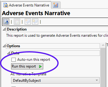

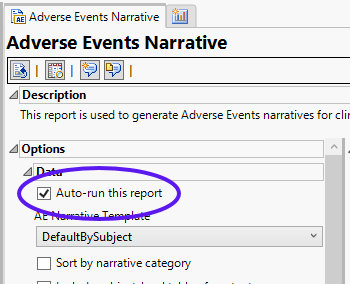

Specifying Auto-run and Manual Run Options
By default, factory reports operate in an auto-run ON manner. Specifically, those widgets that require a report rerun will automatically trigger a rerun when the user changes a widget option value.
For reports where users frequently change multiple options or for reports that simply take a long time to run (especially on large studies), it can be valuable to offer an auto-run toggle and manual run button ("run widgets"). To set this up, do the following things in processNS:runReport():
• Construct the "run widgets" using processNS:makeRunWidgets(defaultChecked = 1|0). A defaultChecked value of 1 specifies that auto-run should be in effect by default and a manual run button will be initially invisible, while a value of 0 specifies that the report will not automatically run when first added (unless overridden by a template) and a manual run button will be initially visible. (To create the widget displaybox container inline, specify a 1 for its second argument.)
• Add the "run widgets" displaybox container reference to the options panel (if the "run widgets" have not already been constructed inline) using objRefNS:RunWidgets.
• Add conditions where needed in the report code to prevent analysis code blocks from running when the report is loaded but not doing a true run (auto-run OFF and a manual run did not occur; code that builds widgets should still execute, to the degree possible), by wrapping analysis sections with if(processNS:shouldRunAnalysis(), ...analysis code...);
The "run widgets" are shown in the blue ovals below:
When auto-run is OFF, the report results panel becomes disabled when arerun-dependent widget option value change is made (to indicate that the results became 'stale').
At the moment that auto-run is switched ON, a rerun is automatically triggered (because of 'stale' results, or because the results do not yet exist) unless no other rerun-dependent widget option value changes have been made since the last run (as the results are still 'fresh').
Like all other ProcessClass widgets, auto-run state is saved to review templates.
