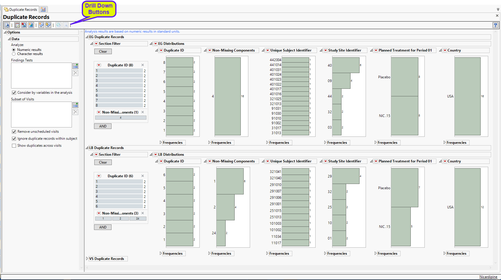

Running Duplicate Records for Nicardipine using default settings generates the Report shown below. In addition, the Ignore duplicate records within subject box was checked to reduce the number of duplicate IDs to less than 3000.
The Report contains distribution plots across all Findings domains. Data that are summarized are those test codes that are constant throughout the course of the study.
Analysis of the Vital Signs domain is shown below:
Vital Signs
Results for the Vital Signs (VS) domain are shown below.
The Vital Signs section contains the following elements:

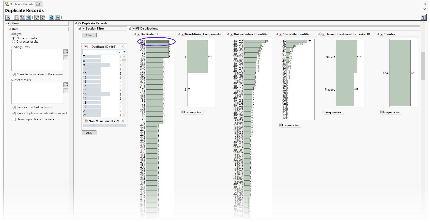

One or more histograms.
The data table underlying these histograms represents records that have at least one duplicate within or between subjects in the trial (depending on options). Therefore, Unique Subject Identifier shows the number of subject records that occur in duplicate bins. Non-Missing Components helps identify duplicate records with a majority of nonmissing data. For example, if ALT, AST, and ALP are analyzed, and for a subject at a certain visit there is no ALT result, then the Missing Component number is 1. Country, Study Site Identifier, and Planned Treatment are provided to show where these duplicates occur most frequently.
See Distribution for more information. Duplicate ID is created only if the number of distinct Duplicate IDs is less than or equal to 3000.

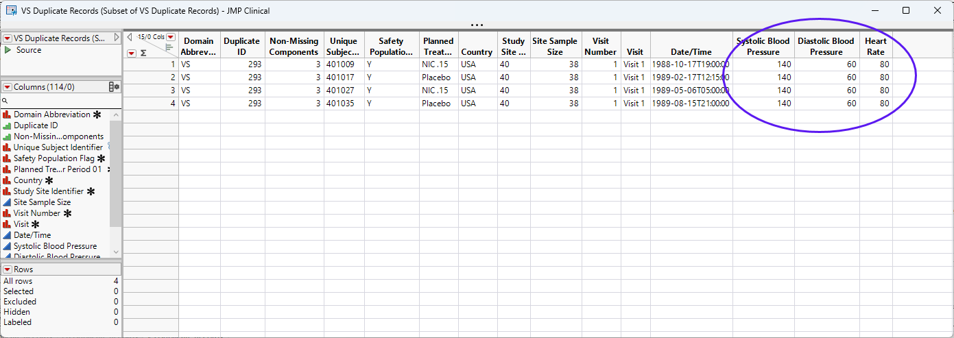

Using the button shows the records for all subjects. To see duplicates, select one group (shown above) and click to view the associated data table. Then click to show just the selected rows. In this case, 4 subjects from the same study site show the same values for blood pressure and heart rate.

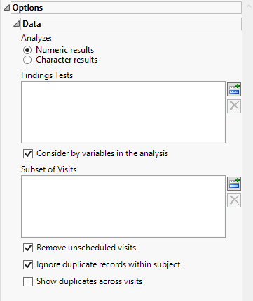

Options
Analyze:
Use this widget to specify whether numeric or character results should be analyzed for duplicates.
Findings Tests
Use this widget to select Findings Tests for the analysis. The report will autorun and analysis is restricted to the selected tests only.
Consider BY variables in the analysis
You can opt to Consider BY variables in the analysis. This option, which assumes that BY variables (left vs. right arm for collecting blood pressure data, for example) are included in the experimental design, is selected by default. You can uncheck this option to ignore BY variables.
Subset of Visits
Use the Subset of Visits option to select the visits to be included in the analysis.
Remove unscheduled visits
You might or might not want to include unscheduled visits when you are analyzing findings by visit. Check the Remove unscheduled visits to exclude unscheduled visits.
Ignore duplicate records within subjects
Under certain circumstances, you may want to ignore select duplicate records. For example, if duplicate entries from a visit are made for a subject, you only want to consider one set of entries. Check the Ignore duplicate records within subject box to delete multiple occurrences of the same subject within each set of duplicate records. If a set of duplicates is based entirely on one subject, these sets are removed.
Show duplicates across visits
By default, JMP Clinical counts identical findings in two or more subjects as duplicates only when they occur within the same site during the same visit. When the Show duplicates across visits check box is checked, however, JMP Clinical counts duplicates even if they don’t happen on the same visit. For example, if there is a site where Subject A's results at Visit 1 match Subject B's results at Visit 2, they are counted as duplicates.
