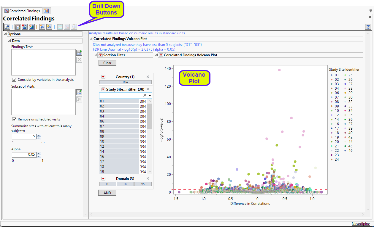

Running Correlated Findings for Nicardipine using default settings generates the report shown below.
The Report contains the following elements:

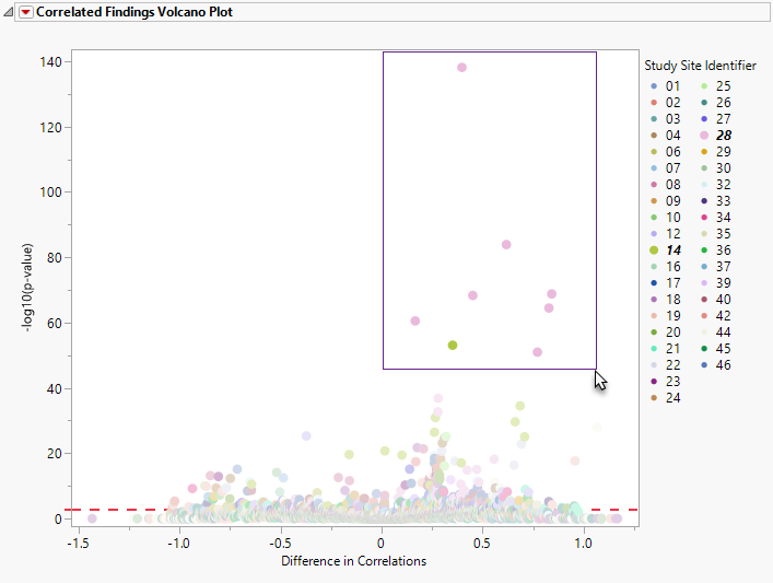

Correlated Findings Volcano Plot
This plot shows points representing the correlations between findings. Points close to zero show little or no correlation. Correlations increase the further (either positively or negatively) they are from zero. Selected points, in the figure below, are positively correlated.

Action buttons provide you with an easy way to drill down into your data. The following action buttons are generated by this report. Use your mouse to select one or more sites of interest before selecting a drill down option, as shown below:

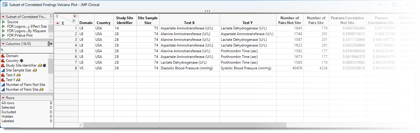

• Show Sites: Shows the rows of the data table for the selected points from the volcano plot. Clicking opens the following table:

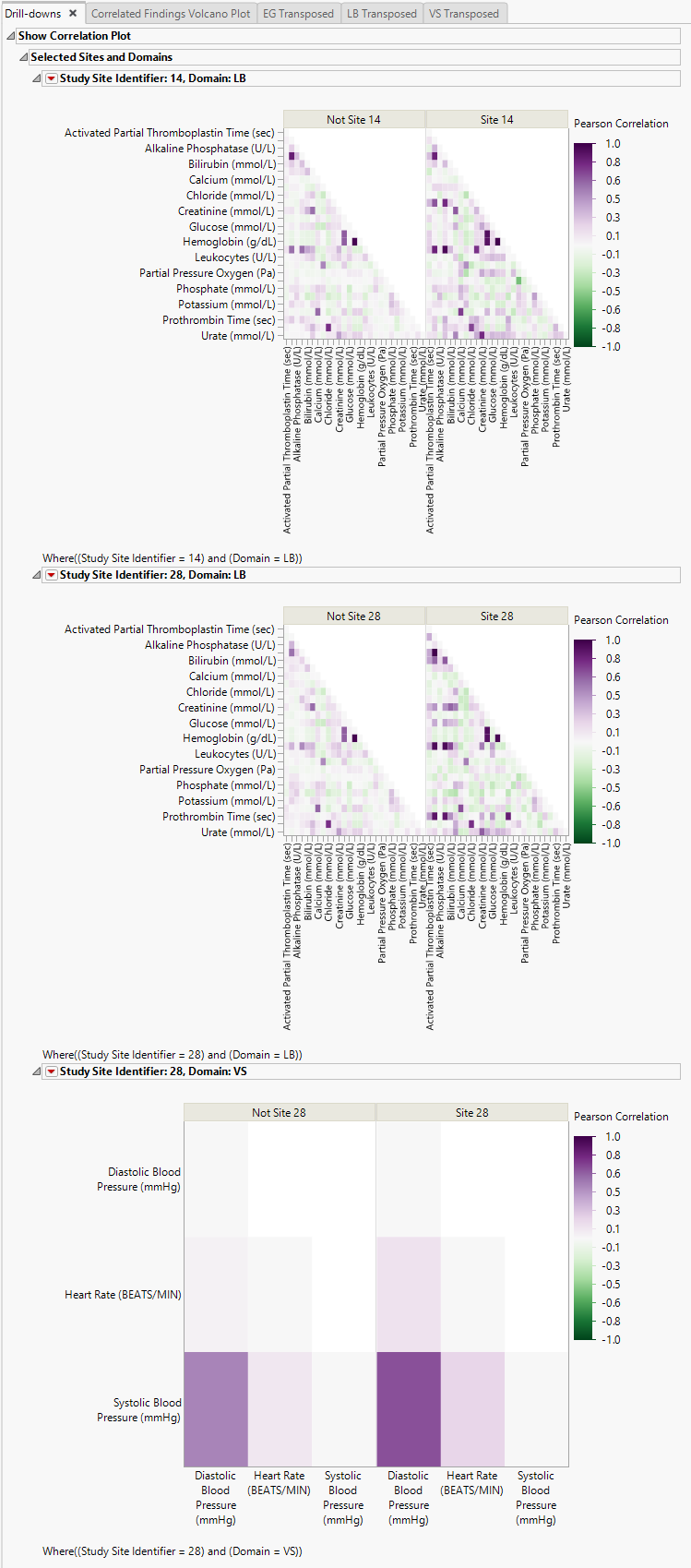

• Show Correlation Plot: Click to display correlation plots for the selected points.
