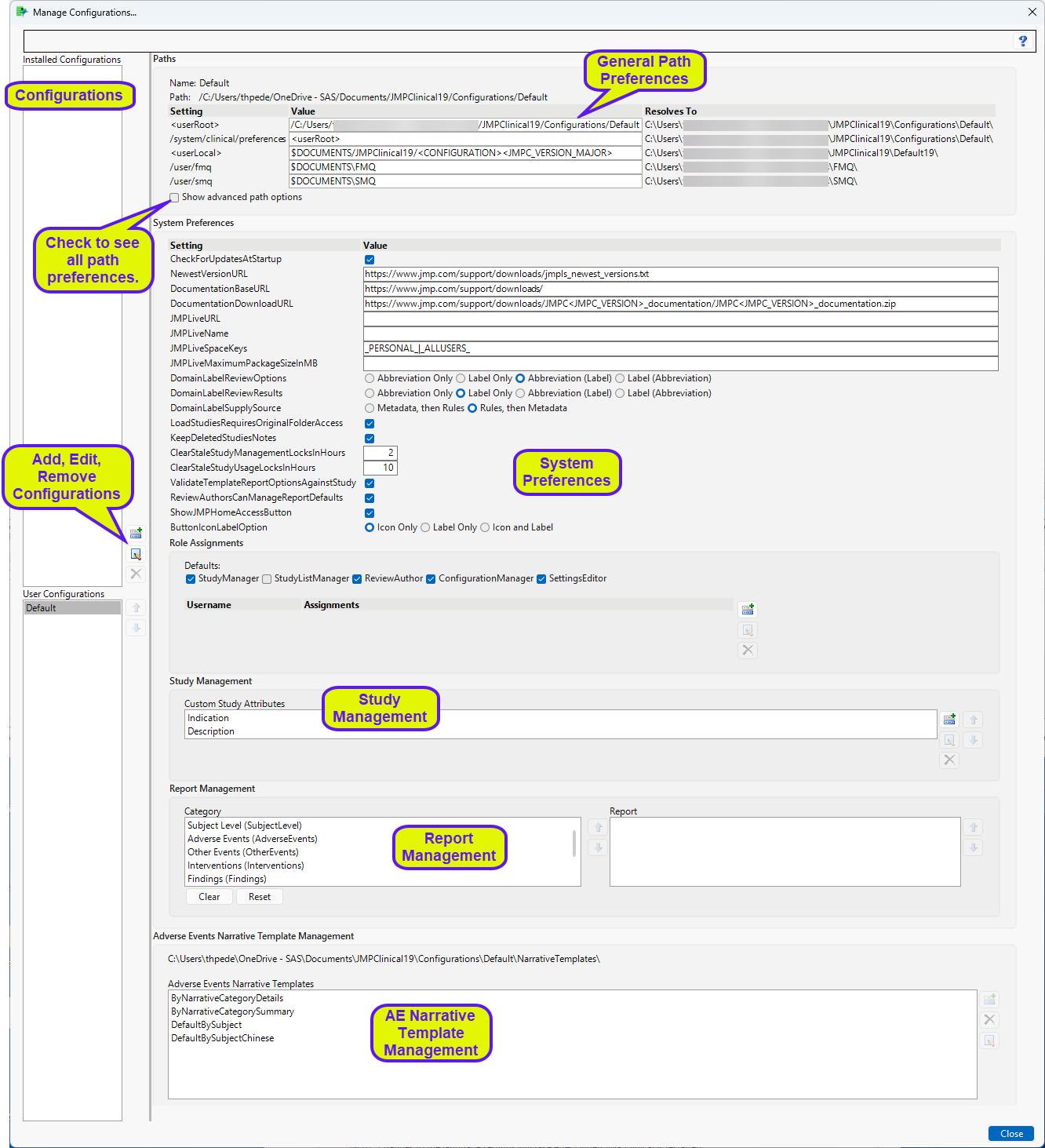

Manage Configurations
The Manage Configurations... window is accessed from the Settings tab of the JMP Clinical Main Window.
8 Click to open the Manage Configurations... window, shown below:

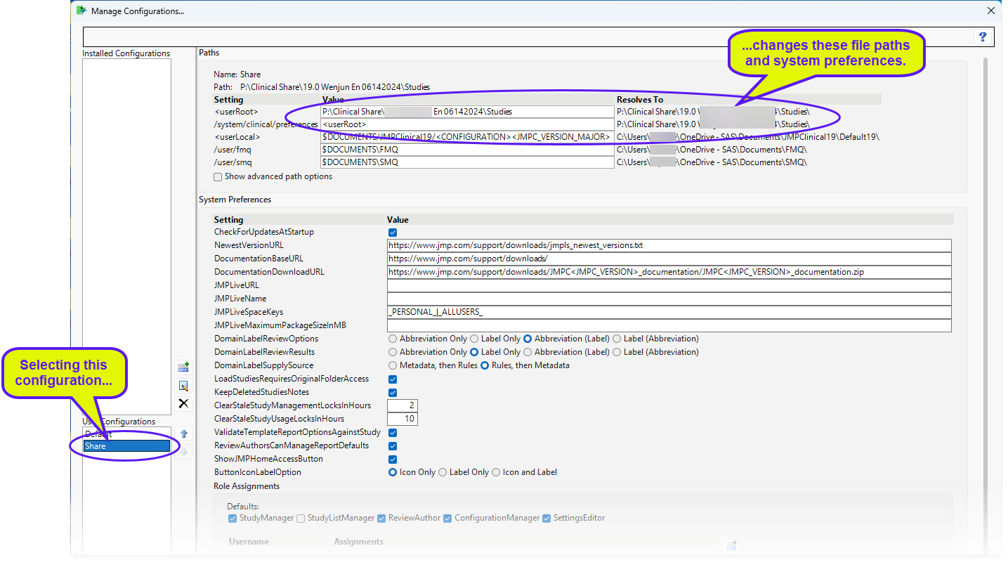

8 Open JMP Clinical and click the Settings tab.
8 Click to open the Manage Configurations... window.
8 Click to open the Add window shown below:
8 Specify a name for your configuration.
In this case, the configuration is named Share.
8 Click to open a Choose Directory window.
8 Navigate into the Clinical Share folder and click .
8 Click the User Configurations radio button.
The Add window appears as shown below:
8 Click .
The new configuration is added to the Manage Configurations window. If you select it, all of the default paths and system preferences are displayed, as shown below:
Note: While all paths and preferences are editable, you should consult your system administrator before making any changes.
8 Click to close the Manage Configurations window.
Note: Anyone with Read and Write privileges on the shared drive has access to a new shared folder. As the creator of this folder you can control level of access by changing the permissions using WinOS commands.
