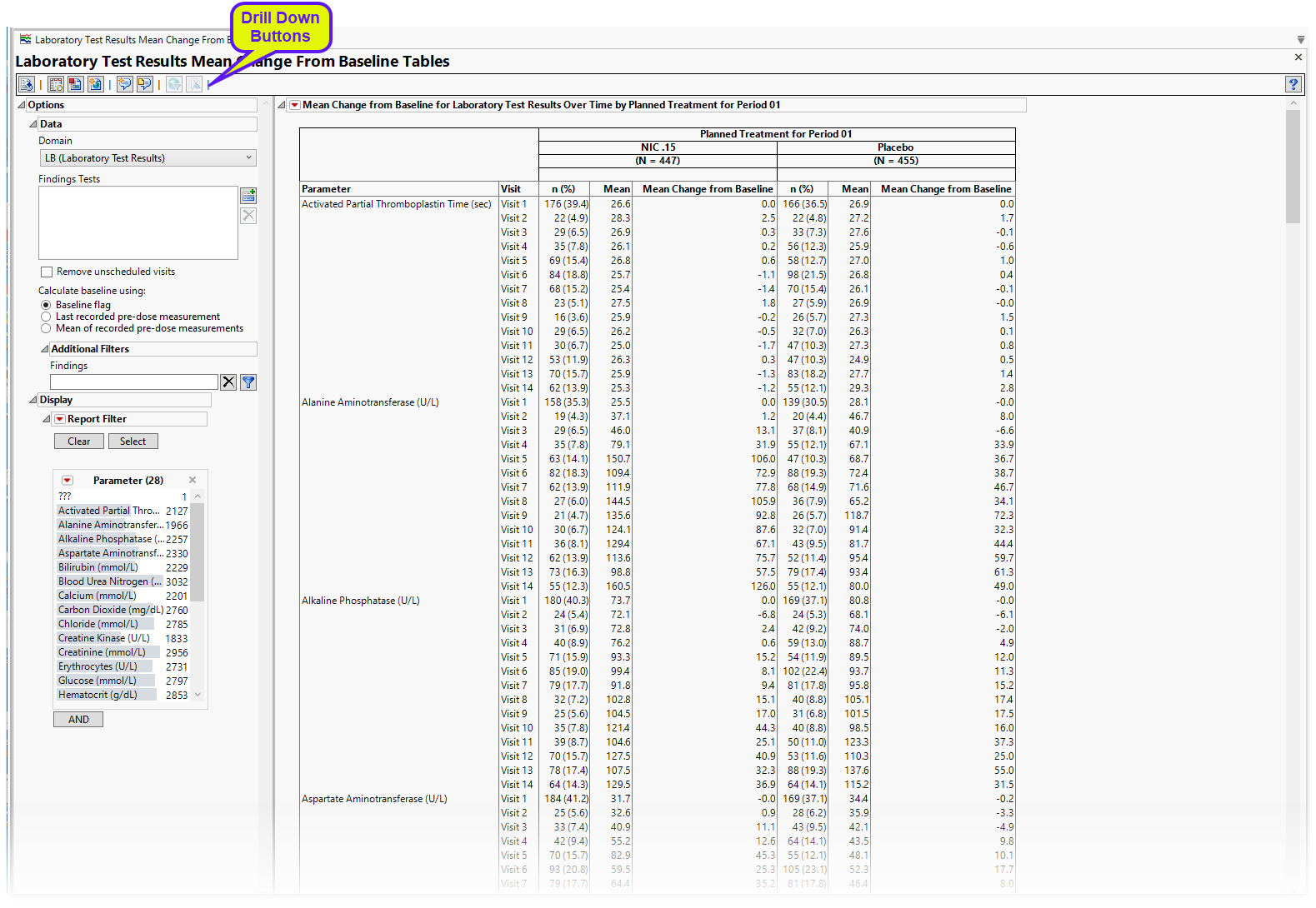

Running Findings Mean Change from Baseline Tables for Nicardipine using default settings generates the report shown below.
It contains the following elements:
• One table listing the number (percentage) of subjects in each arm that had a post-baseline record at each visit. The mean represents the mean change from baseline for those findings results among the patients who had a record. Each subject’s respective baseline value is used to calculate the change from baseline for each visit. Then, all the subjects' individual change from baselines are totaled and the mean is then calculated. This is the value of mean change from baseline that is entered in the table for that respective visit.

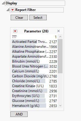

Display
Report Filter
This widget enables you to subset and view subjects based on demographic characteristics and other criteria. By default, the filter in this report enables you to filter by findings tests. Refer to Data Filter for more information on filters.
