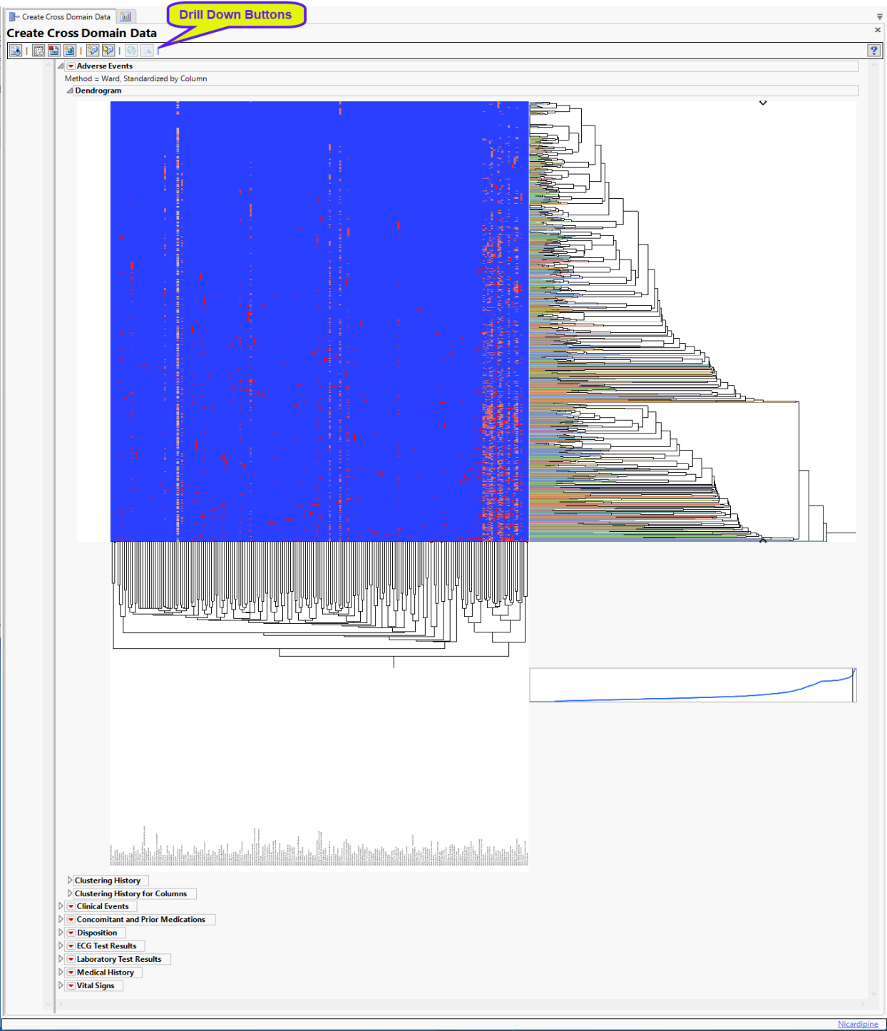

Running this report with the Nicardipine sample setting generates the Results shown below. Output from the report is organized into sections. Each section contains one or more plots, data panels, data filters, or other elements that facilitate your analysis.
Hierarchically clusters all binary indicator variables. A separate section is created for each domain (Adverse Events (AE), Clinical Events (CE), Concomitant and Prior Medications (CM and MH), Disposition (DS), Electrocardiogram (ECG), Hi and Low Laboratory Results (LB), Medical History (MH), and selected Vital Signs (VS)) that has binary variables, depending on the options selected. The binary variables are converted to 0s and 1s and clustered.
The AE Indicators section is shown below:
An Indicator section contains the following elements:

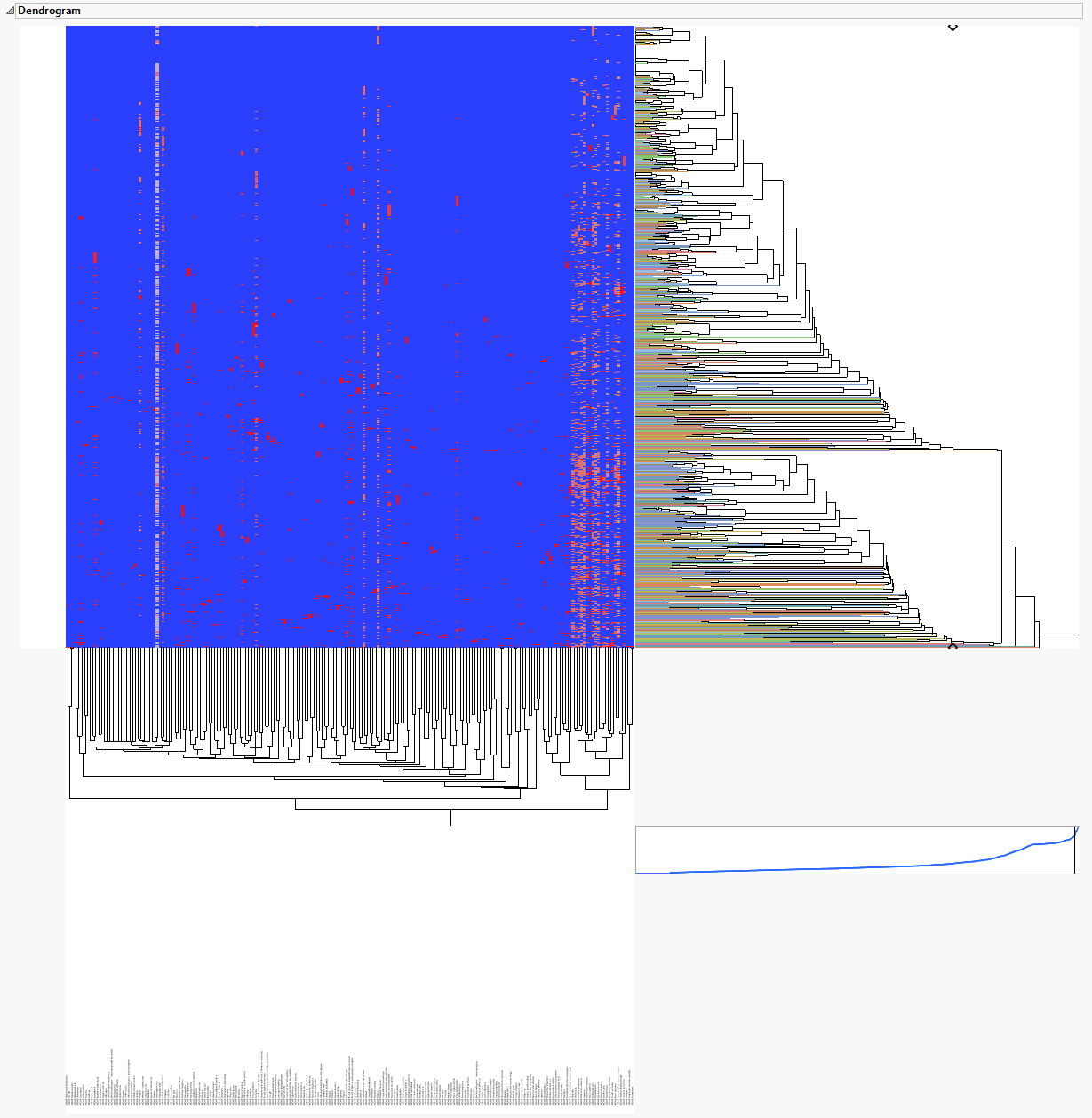

| • | A two-way hierarchical clustering analysis of the 0-1 variables, with subjects as rows and indicator variables as columns. |
You can study the Heat Map and Dendrogram to see both subjects that have similar values of the binary variables as well as binary variables that are similar across subjects.
