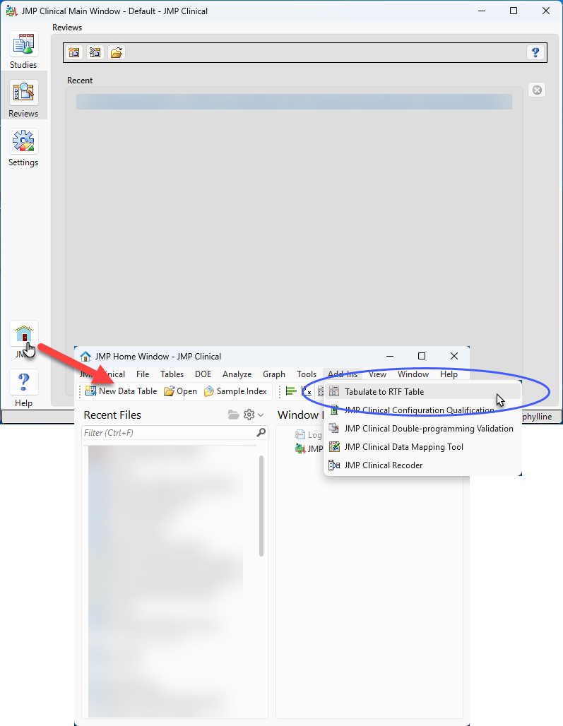

8 To access this tool, click on the JMP Clinical Main Window to open the JMP Home Window.
8 Click Add-Ins > Tabulate to RTF Table to open the tool.
Note: If this is the first time you are opening the Add-In, you will be prompted to register it.

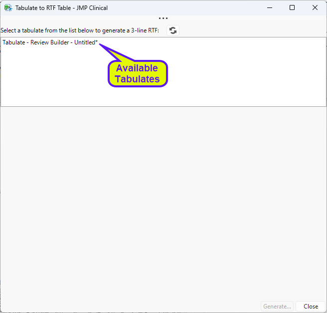

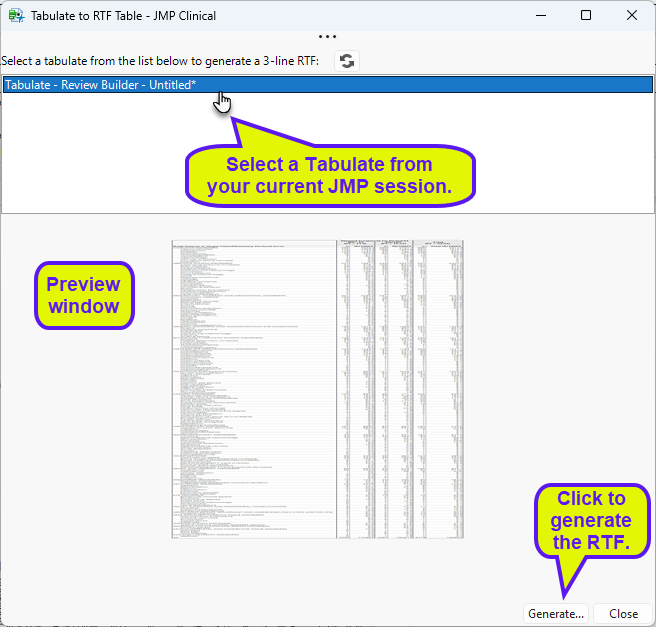

The tool contains a list of the tabulates from your current JMP Clinical session, a Preview window, and several action buttons.

• Click to refresh the list of tabulates.
• Click to generate the RTF file.
• Click to close the tool.
