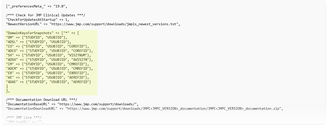

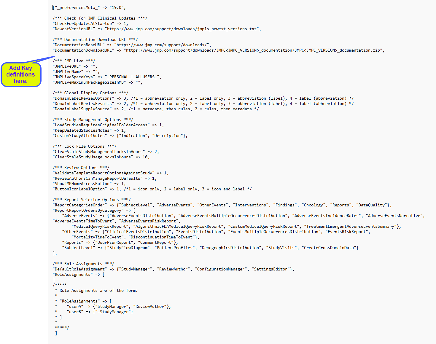

Specifying Alternative Keys
Use the following procedure for specifying alternative keys:
8 Navigate to the location of the system.clinical.preferences file. Typically, this file is located in the ‘C:\Users\<username>\Documents\JMPClinical19\Configurations\Default’ directory.
8 Make a copy of the system.clinical.preferences file and save it under a different name to ensure that you retain a copy of the default file.
8 Open the system.clinical.preferences file.
8 Insert the nested associative array that specifies the keys to be used with your study. The array code should be inserted into the system.clinical.preferences file at the location shown above.
In this example, we insert the following array:
"DomainKeysForSnapshots" => ["*" => [
"DM" => {"STUDYID", "USUBJID"},
"ADSL" => {"STUDYID", "USUBJID"},
"CO" => {"STUDYID", "USUBJID", "COREFID"},
"ADCO" => {"STUDYID", "USUBJID", "COREFID"},
"SV" => {"STUDYID", "USUBJID", "VISITNUM"},
"ADSV" => {"STUDYID", "USUBJID", "AVISITN"},
"CM" => {"STUDYID", "USUBJID", "CMREFID"},
"ADCM" => {"STUDYID", "USUBJID", "CMREFID"},
"EX" => {"STUDYID", "USUBJID", "EXREFID"},
"AE" => {"STUDYID", "USUBJID", "AEREFID"},
"ADAE" => {"STUDYID", "USUBJID", "AEREFID"}
The modified system.clinical.preferences file is shown below. The array is shaded in yellow.
8 Save the system.clinical.preferences file and close JMP Clinical.
You must close and restart JMP Clinical for the changes to the system.clinical.preferences file to take effect.
To revert to the default keys, delete the system.clinical.preferences file from the ‘C:\Users\<username>\Documents\JMPClinical19\Configurations\Default’ directory. Rename your saved copy to system.clinical.preferences, and close and reopen JMP Clinical.
