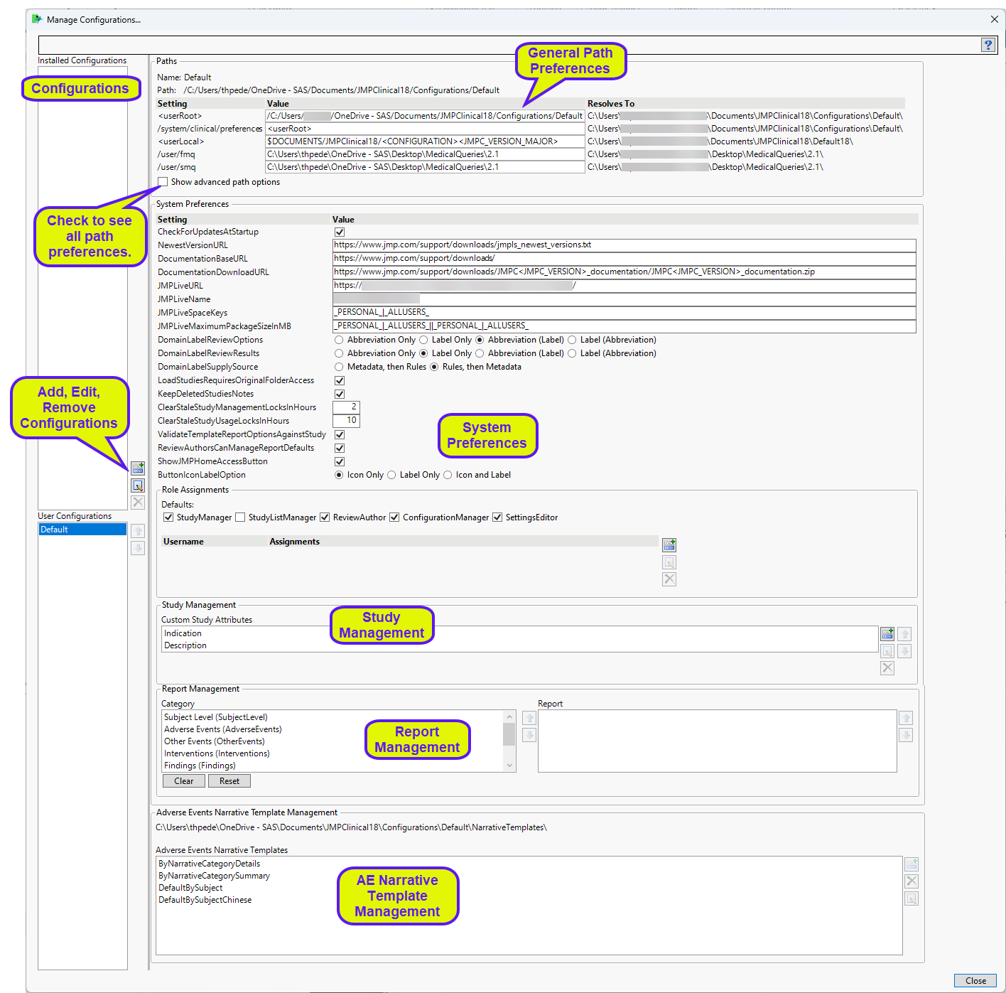

Manage Configurations
The Manage Configurations... window is accessed from the Settings tab of the JMP Clinical Main Window.
8 Click to open the Manage Configurations... window, shown below:

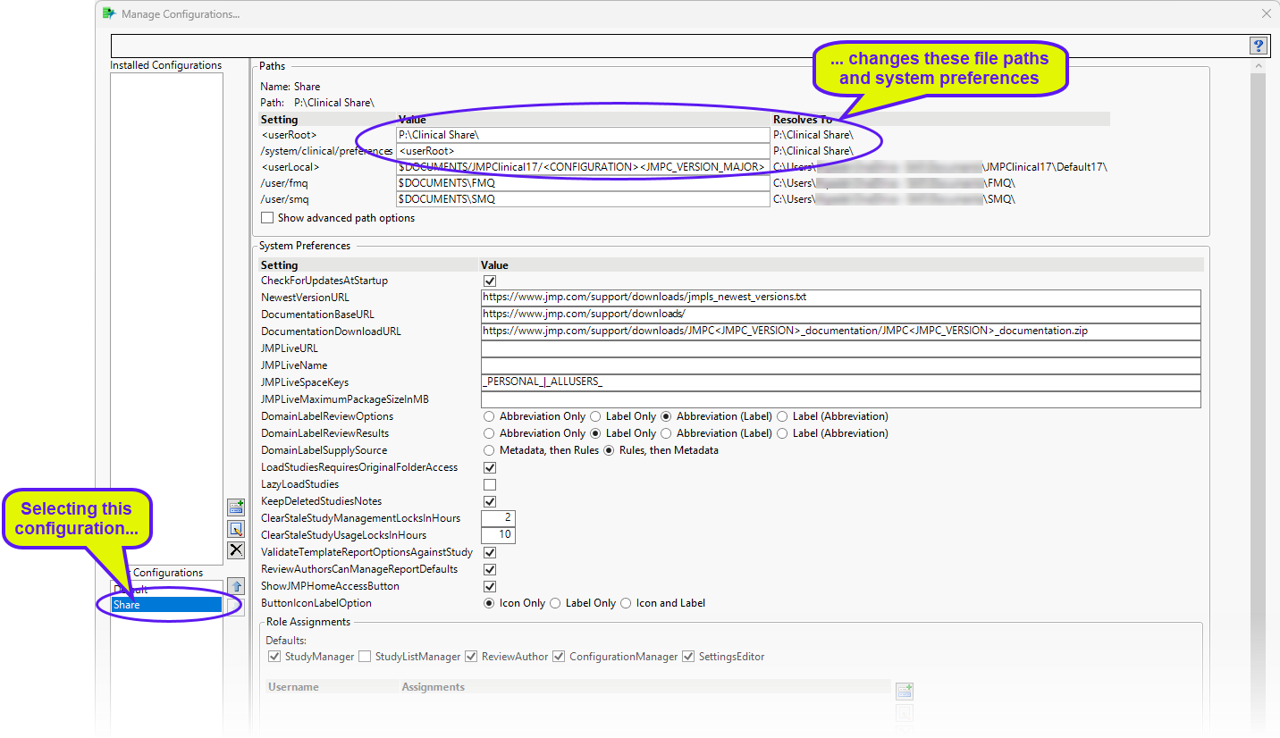

Adding a New Configuration
In this example, we create a new configuration named Share.
Note: You must have a Configuration Manager role assignment and Write privileges to the relevant folders to add a configuration.
Determine the location for your configuration files.
8 If the planned location is on your local machine, navigate to the folder where you want to put your configuration files.
8 If the planned location is on a shared or network drive, use OS commands to map the drive where the new folder is to reside.
In this example, the shared drive is defined as drive U:. Note: Your file path will be different.
8 Create a new folder in the mapped location.
In this case, we will name the folder ClinicalShare. This folder will serve as the root directory for the new shared configuration.
8 Open JMP Clinical and click the Settings tab.
8 Click to open the Manage Configurations... window.
8 Click to open the Add window shown below:
8 Specify a name for your configuration.
In this case, the configuration is named Share.
8 Click to open a Choose Directory window.
8 Navigate into the Clinical Share folder and click .
8 Click the User Configurations radio button.
The Add window appears as shown below:
8 Click .
The new configuration is added to the Manage Configurations window. If you select it, all of the default paths and system preferences are displayed, as shown below:
Note: While all paths and preferences are editable, you should consult your system administrator before making any changes.
8 Click to close the Manage Configurations window.
Note: Anyone with Read and Write privileges on the shared drive has access to a new shared folder. As the creator of this folder you can control level of access by changing the permissions using WinOS commands.
File Path Options for a Configuration
File path options are set defined for the default configuration when JMP Clinical is first installed. File path options for a new configuration are set automatically when the configuration is set up and added. File paths are modifiable.
Note: All paths are defined in the installation.path.preferences file. Most users will never need to manually change any of these paths. You should never open and directly edit the installation.path.preferences file. Any changes that need to be made can be done in the Manage Configuration... window and should be made only by an experienced System Administrator.
File paths are specified using the following syntax:
{“PathKey”, “PathValue”},
Note the braces ({}) enclosing the key-value pair, the key enclosed in double quotation marks (“”), the comma (,) after the key, the value enclosed in double quotation marks, and the comma following the enclosed key-value pair unless it is the final key-value pair in the file.
Paths are described below.

System Preferences
System preferences enable you to set preferred behaviors for JMP Clinical. Options include automatic checking for updates specifying how domains and buttons are identified on the user interface, which dates and snapshots to honor when comparing studies, and so on. Use the available controls to customize your installation of JMP Clinical.
See the tables below for descriptions of each option:

Role Assignments
By default, a JMP Clinical installation is fully functional with all reports and options available to you. However, the JMP Clinical installed on your machine, might be configured for a specific user role. These roles are set as described in Adding Users and Specifying Role Assignments.
What follows here is a brief description of each of the JMP Clinical user roles and how to specify roles for each user.

Study Management
Report Management
The Report Management option enables you to specify the order in which the report categories and the reports themselves are presented in the review.
Adverse Events Narrative Template Management
The Adverse Events Narrative Template Management option enables users to add/remove selected templates that are available for the selected configuration. Configurations shared among users are immediately impacted by changes made to the list of available templates.
The Adverse Events Narrative Templates section lists all of the templates currently in the selected configuration. The templates are listed by their names (name of the base VM file) and the date/time of the last modification. You can add, remove, or edit templates using the action buttons.
The button is enabled if there are templates that are in the JMPC installation location (as per the installation.path.preferences file) that are NOT in the configuration's template location (also per the the installation.path.preferences). Note that existence is based on name and modification date/time. That is, a template may appear to be in the configuration and the install (have the same name), but if the modification date/times don't match, it is available for adding. In the cases where there isn't a match between the configuration and installation, the template is marked with a trailing asterisk (*).
The button is used to remove a template from the configuration. In the cases where these isn't a template match, a warning is issued that the selected template cannot be recovered once deleted. This is to handle the cases where a configuration has templates that were added outside of the installation.
Finally, the button attempts to launch (open) the .VM files that comprise the selected template. This is simply delegating the edit action to the OS. The editing program selected depends on you machine's operating system preferences.
