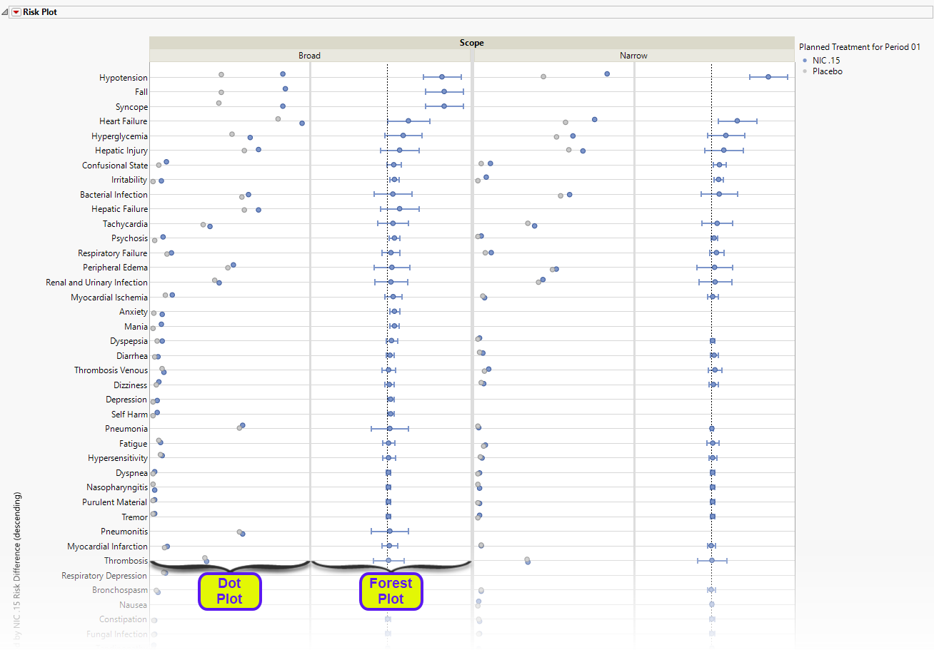

There are four plots shown here: a group of two plots for broad scope queries and a group of two plots for narrow scope queries. Medical queries are shown on the y axis. The dot plot on the left of each group shows the percentile occurrence of subjects in each arm exhibiting the queries. The Forest plot on the right of each group shows the risk difference for subjects to exhibit events covered by each query.
Forest Plots display relative strength of treatment effects as horizontal lines representing the 95% confidence interval of the effect observed in that trial. The confidence interval is normally for the relative likelihood of a given nominal-level outcome for the intervention group compared to the control group. In this example, the forest plot shown below, represents the risk difference for developing the specified event relative to exposure to Nicardipine.

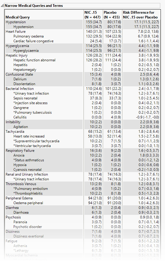

Narrow Medical Queries and Terms
This table lists each narrow query with its associated dictionary-derived terms, the number (percentile) of subjects exhibiting the event, and the risk difference between the treatment arms.

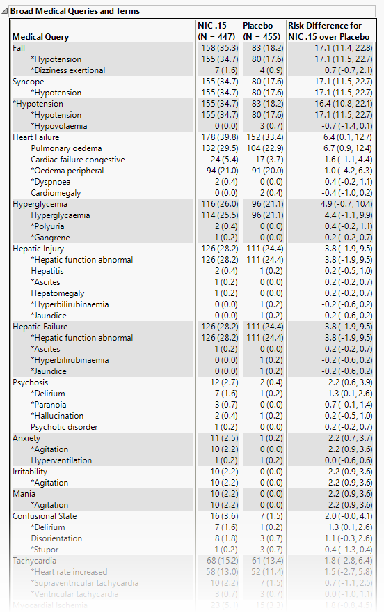

Broad Medical Queries and Terms
This table lists each broad query with its associated dictionary-derived terms, the number (percentile) of subjects exhibiting the event, and the risk difference between the treatment arms.

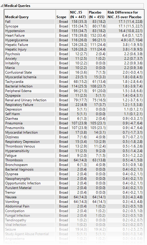

Medical Queries
This table summarizes each query without the associated dictionary-derived terms for the number (percentile) of subjects exhibiting the event, and the risk difference between the treatment arms.

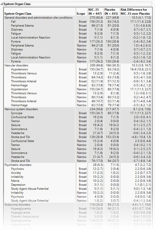

System Organ Class
This table lists the number (percentile) of subjects exhibiting each SOC and the risk difference between the treatment arms.
Note: When SMQs are selected, SOCs are thos contained in the AEBODSYS columnfrom either AE or ADAE . Alternatively, when FMQs are selected, the SOCs are those matched to the FMQ in the FMQ References tab of the Excel file.

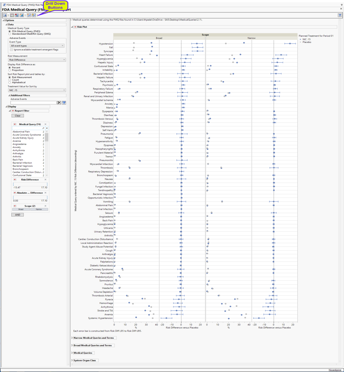

You can click on the subjects displaying specific events described by the medical queries to bring up the Drill-downs tab that provides more details about the specific subjects and medical query along with several additional tables with more details.

Action buttons, provide you with an easy way to drill down into your data. The following action buttons are generated by this report:
