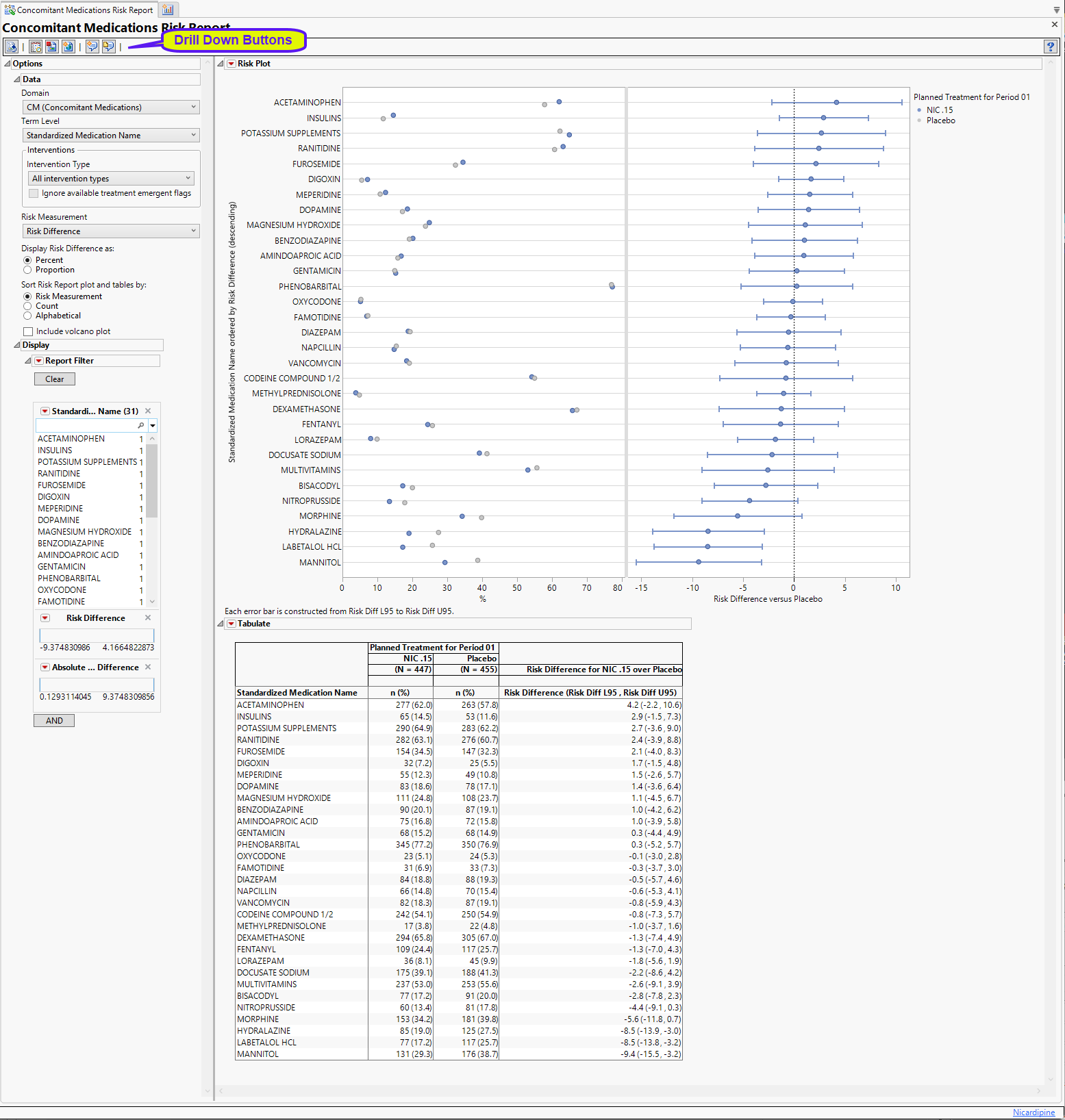

Interventions Risk Report
This report screens all interventions and calculates and generates forest plots of risk differences, relative risks or odds ratios. It reports each subject only once per intervention regardless of how many incidents of the intervention occur.
Report Results Description
Running this report for Nicardipine using default settings generates the report shown below.
Refer to the Adverse Events Risk Report , keeping in mind the following important differences in contrast with the example:
• Output (including section names) reflects intervention incidence corresponding to selected domain (e.g. Concomitant Medication, Substance Use), rather than adverse events, incidence
• Term Level is allowed to equal Category (such as CMCAT or SUCAT, depending on the domain)
Refer to Confidence Intervals for information on how JMP Clinical calculates and uses confidence intervals.

Action buttons, provide you with an easy way to drill down into your data. The following action buttons are generated by this report:
• Click to reset all report options to default settings.
• Click to view the associated data tables. Refer to Show Tables/View Data for more information.
• Click to generate a standardized pdf- or rtf-formatted report containing the plots and charts of selected sections.
• Click to generate a JMP Live report. Refer to Create Live Report for more information.
• Click to take notes, and store them in a central location. Refer to Add Notes for more information.
• Click to read user-generated notes. Refer to View Notes for more information.
