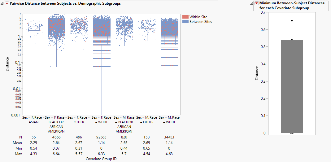

• Box plots are presented for all pairwise distances between subjects in the selected population. Individual points are overlaid with the box plot, with the colors differentiating 'Between Sites' and 'Within Site' distances. The Y-axis is set to log-scale by default for the ease of identifying small distance points when the range of distance is large. A summary table is shown below the boxplot presenting the N, Mean, Min, Max values for each covariate group.
In this example, box plots are presented by gender and race. The more similar a pair of subjects, the smaller the distance value (a zero indicates a perfect match). Note that when using the log-scale, the zero values are not presented in the graph (e.g. Sex=F, Race=WHITE and Sex=M, Race=WHITE), but can be observed in the statistics summary table.
• One Box Plot of Minimum Between-Subject Distances for Each Site. The minimum distance from each covariate subgroup is presented in the box plot to the right.
The subgroup with the most similar pair of subjects is presented in the Subgroup Clustering section.

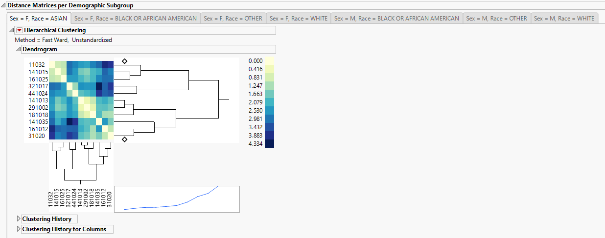

One or more Subgroup Clustering sections: The Hierarchical clustering results for each demographic subgroup are presented in different panels. The name of a panel is dependent on the covariate values used.
The Sex = F, Race =ASIAN subgroup clustering section is shown below:
• A heatmap with subject IDs being rows and columns annotations. The legend shows the pairwise distance values with a minimum of zero. All the pairwise distance matrices, along with the subjects' ID , study sites and treatment arms, are stored in separate jmp tables, and can be accessed by clicking the 'Show Tables' button.
• Two tables showing the clustering history for the rows and columns.

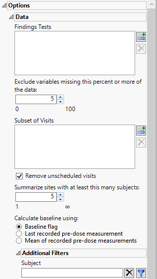

Data
Findings Tests
Use this widget to select Findings Tests for the analysis. The report will autorun and analysis is restricted to the selected tests only.
Exclude tests missing this percentage or more of the data:
By default, findings analyses are conducted assuming that sufficient numbers of subjects have participated to make the results statistically significant. Use this option to specify a threshold at which the level of missing data becomes unacceptable. Tests with levels of missing data exceeding this threshold are removed from the analysis for that visit and time point. The default value for this threshold is 30%, so any tests missing data from more than 30% of the subjects at Visit x are removed from the analysis of that visit.
Subset of Visits
Use the Subset of Visits option to select the visits to be included in the analysis.
Remove unscheduled visits
You might or might not want to include unscheduled visits when you are analyzing findings by visit. Check the Remove unscheduled visits to exclude unscheduled visits.
Summarize sites with at least this many subjects:
The Summarize sites with at least this many subjects: widget enables you to set a minimal threshold for the sites to be analyzed. Only those sites which exceed the specified number of subjects are included. This feature is useful because it enables you to exclude smaller sites, where small differences due to random events are more likely to appear more significant than they truly are. In larger sites, observed differences from expected attendance due to random events are more likely to be significant because any deviations due to random events are less likely to be observed.
Calculate baseline using:
Use the Calculate baseline using: widget to use one of the following: i) baseline flag variable, ii) the last recorded pre-dose measurement, or iii) the mean of all the measurements taken during the baseline time window as the baseline measurement.
Additional Filters - Subject
This filter lets you restrict your analysis to only those subjects that meet specific subject criteria at the domain level (ADSL or DM). The filters uses JMP WHERE clauses to Select Rows that meet the specified criteria. To use this filter, you must enter the JSL (JMP Scripting Language) expressions that constitute the WHERE clause in the appropriate text box for specific filtering of AEs, Disposition, Findings, and/or Subjects. Note: This is an advanced concept that not only requires some basic knowledge of the JSL where clause syntax (similar to, but different from, SQL), but also an understanding of the exact variables in the tables in the study.

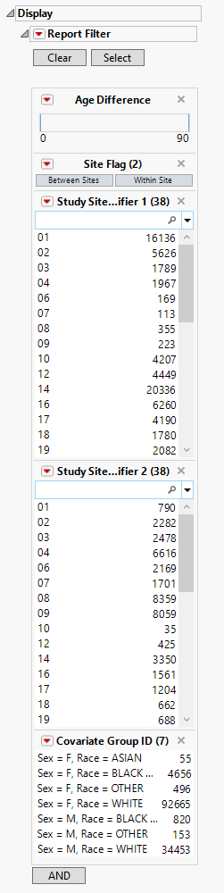

These filters enable you to subset and view subjects based on demographic characteristics (Age Difference, Site Flag), study sites (Site IDs for the two subjects in the pairwise comparison), and other criteria (covariate ID).
Refer to the Data Filter documentation for more information

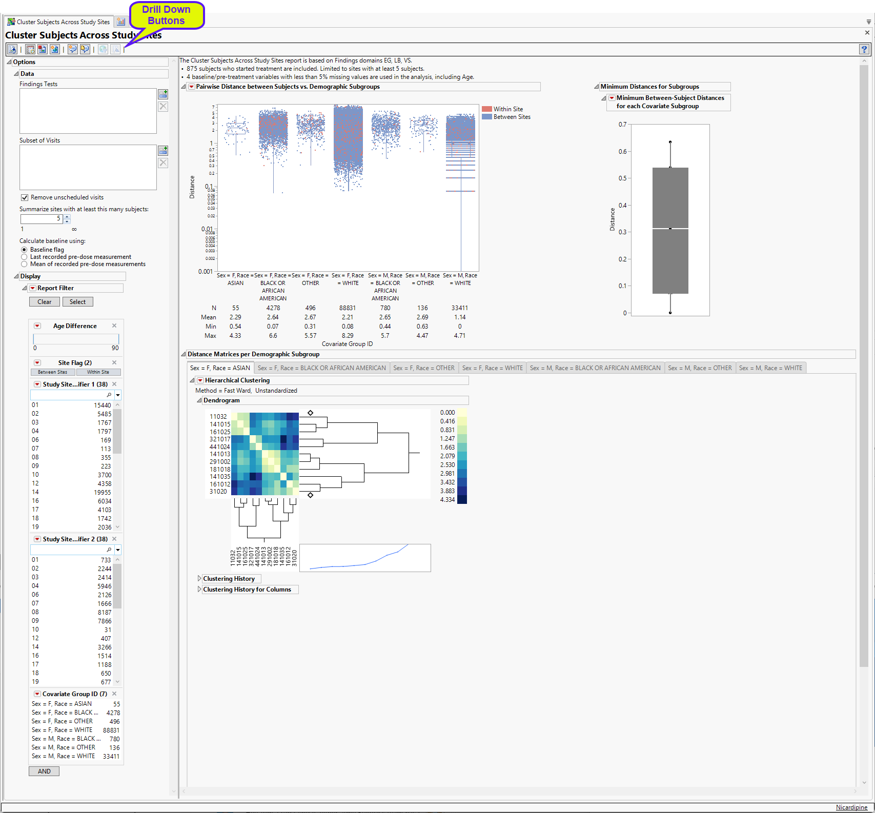

Action buttons, provide you with an easy way to drill down into your data. The following action buttons are generated by this report:
• Click to rerun the report using default settings.
• Click to view the associated data tables. Refer to Show Tables/View Data for more information.
• Click to generate a standardized pdf- or rtf-formatted report containing the plots and charts of selected sections.
• Click to generate a JMP Live report. Refer to Create Live Report for more information.
• Click to take notes, and store them in a central location. Refer to Add Notes for more information.
• Click to read user-generated notes. Refer to View Notes for more information.
• Click to open and view the Review Subject Filter.
• Click to specify Derived Population Flags that enable you to divide the subject population into two distinct groups based on whether they meet very specific criteria.
