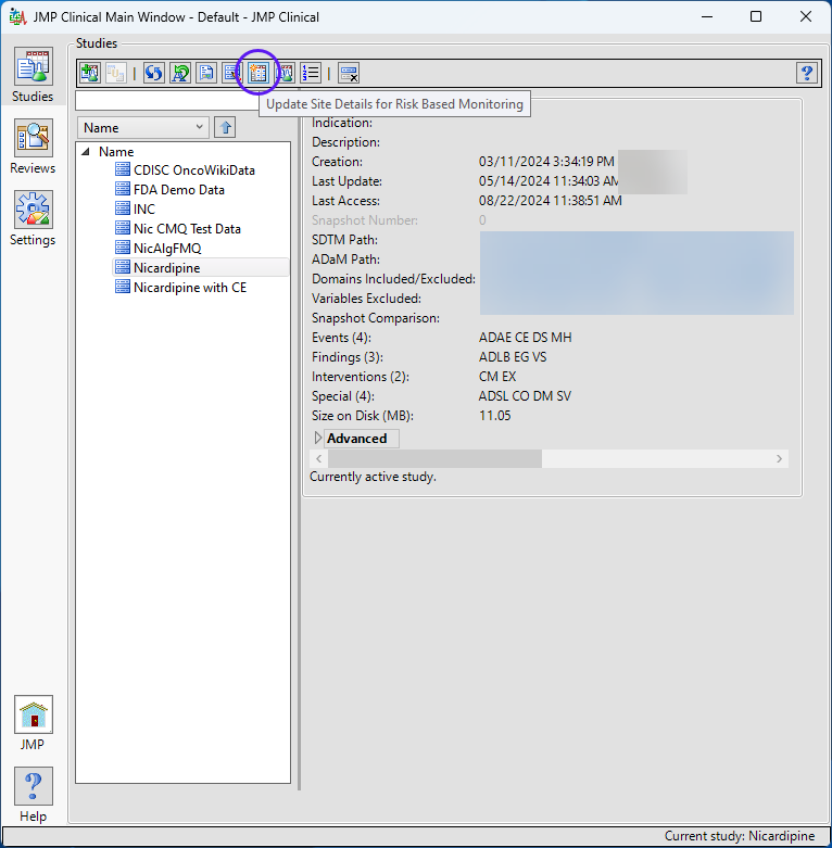

Updating the Study Risk Data Set With Supplemental Data
The Update Site Details for Risk Based Monitoring option is accessed using an action button on the Studies tab of the JMP Clinical Main . (See below.)
Clicking this action button opens the Study Risk data set (shown below). Note that only site level classifications are supplied.
