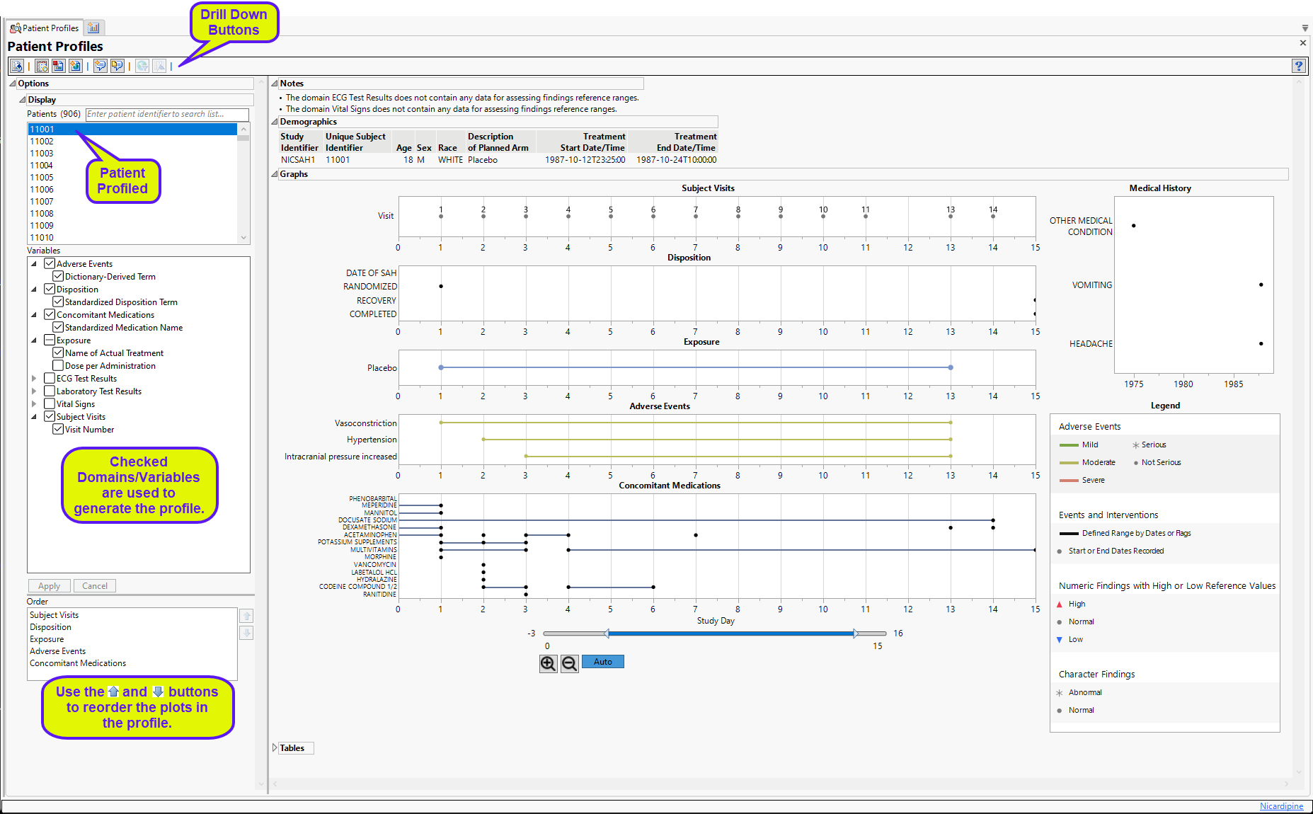

Running this report for the Nicardipine example using default settings generates the Report shown below.
In addition to the profile shown above, the report also contains the following notes window.
The data window contains any notes generated by the report.
Note: The Patient Profiler now responds to and honors selections made in the Review Subject Filter.
Note: Prior versions of JMP Clinical had precompute functionality in this report. This functionality is now managed automatically.
The Patient Profiler window contains the following elements:

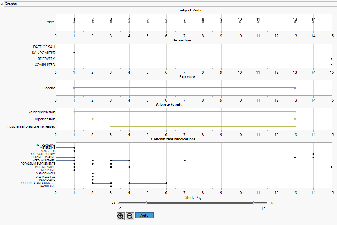

• One Subject Profile.
This is the principal display. Time1 is displayed along the x-axis and data values from selected domains are grouped along the y-axis. When duration information is available, points are joined with a horizontal line.
8 Use the slider and zoom controls below the plot to adjust the view. Click to reset the view to the default view.
The color and shape of points is domain dependent and is described in the Legend pane.

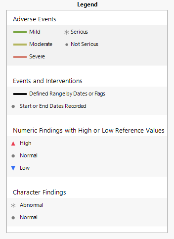

• One Legend.
This pane describes the colors and symbols used in the primary display.
The top panel (shown below) denotes symbols and colors used for adverse events. Blue, green, or red bars indicate that the events are mild, moderate, or severe, respectively, as specified by the values in the SDTM variable aesev
. When you specify aetoxgr instead of aesev in your AE or ADAE domain, the color scale has four levels instead of 3.
Note: For both cases (aesev and aetoxgr) shown above, the colors can be changed at the Study level using the Set Value Order and Color in Studies option.
The asterisk () and filled-circle ( ), in both cases, indicate whether the condition is serious or not serious, respectively, as specified by the values in the variable aeser.
Note: Serious conditions are generally, but not necessarily, severe.
The middle panel (shown below) denotes line formats and symbols used for dates and times of different events and interventions.
Events or interventions with a defined range are indicated by a solid line spanning the ranges. Start and End dates are denoted by a filled-circle ().
The bottom panel (shown below) differentiates levels of findings for numeric and character findings.
Numeric findings that exceed the specified maximum reference value (also defined as the upper limit of normal or ULN) are indicated by an upward arrow ( ). Findings that fall below the specified minimum reference value (also defined as the lower limit of normal or LLN) are indicated by a downward arrow ( ). Findings between the ULN and LLN are indicated by a filled-circle (). The normal range is considered to be the median value over all subjects +/- 1.5 x the interquartile range (IQR). Findings falling within that range are are indicated by a filled-circle ( ).
Normal character finding are indicated with a filled circle ( ). Character findings considered abnormal are indicated by an asterisk ( ).

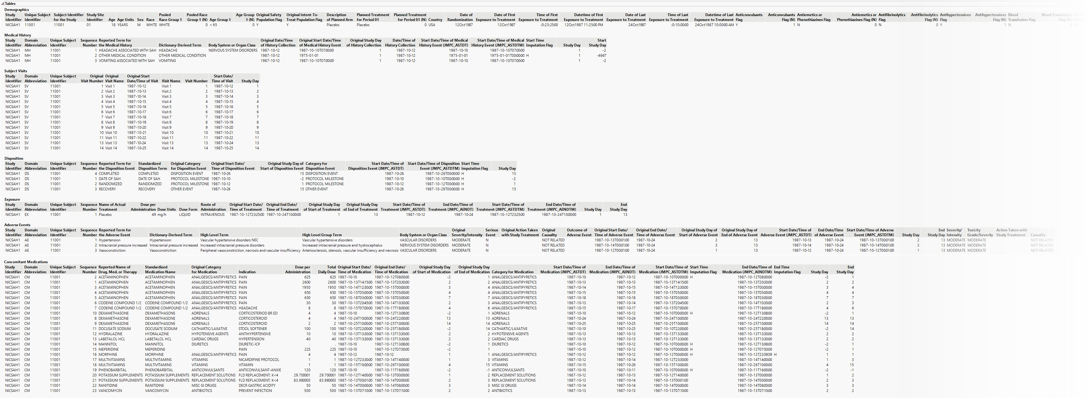

Tables
The Tablessection is shown below:
The Tables section lists and summarizes subject-level data for the profiled subject in tabular form.

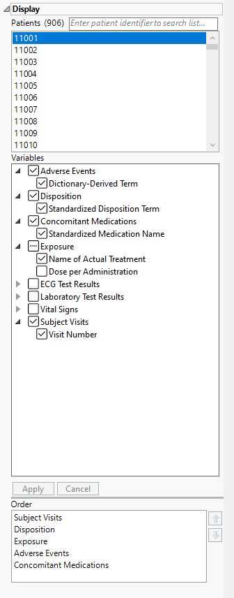

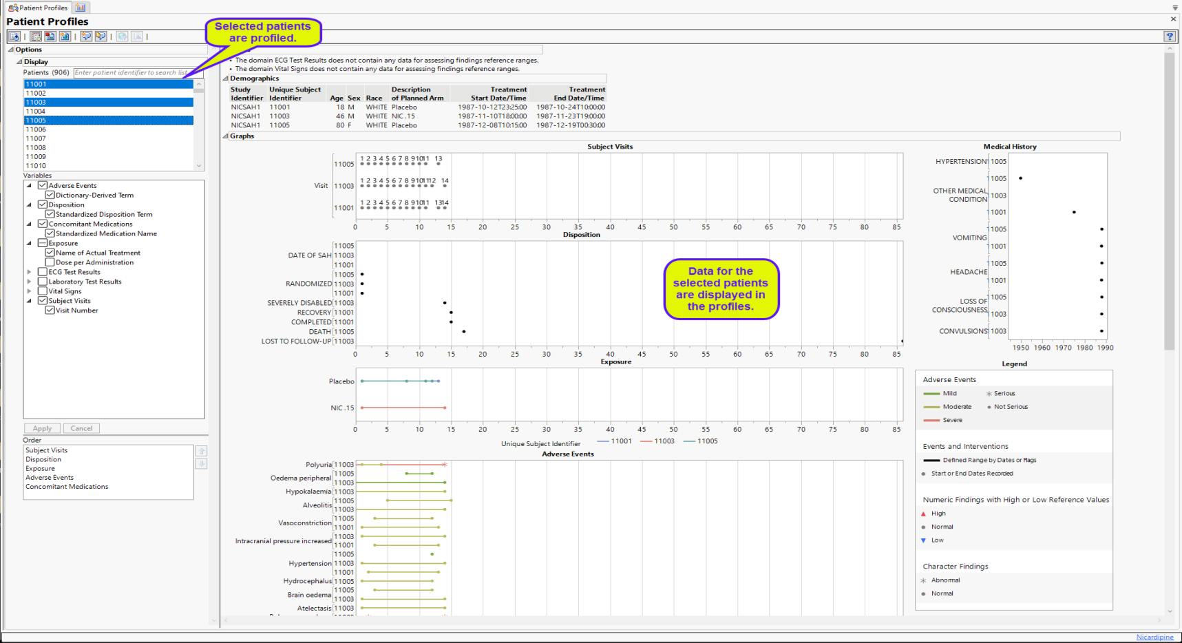

Patients
This widget enables you to select which patients to profile. Hold the Ctrl key to select multiple patients or the Shift key to select contiguous patients among those listed. Shown below is a partial Profile display for three selected patients.
Variables
This widget enables you select the domains and variables to include in your profiles. Click to expand the domains and display the variables that may be selected. Click within the check boxes to select desired domains and variables. . Click to apply any changes to the variables to be profiled.
Order
This widget allows you to specify the order in which the different plots are displayed. Select a category and use the and buttons to move the category up or down in the order sequence.
Action buttons, provide you with an easy way to drill down into your data. The following action buttons are generated by this report:
• Click to rerun the report using default settings.
• Click to view the associated data tables. Refer to Show Tables/View Data for more information.
• Click to generate a standardized pdf- or rtf-formatted report containing the plots and charts of selected sections.
• Click to generate a JMP Live report. Refer to Create Live Report for more information.
• Click to take notes, and store them in a central location. Refer to Add Notes for more information.
• Click to read user-generated notes. Refer to View Notes for more information.
• Click to open and view the Review Subject Filter.
• Click to specify Derived Population Flags that enable you to divide the subject population into two distinct groups based on whether they meet very specific criteria.
