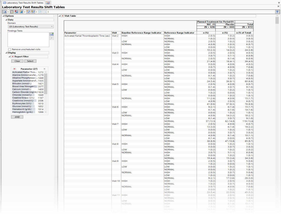

Findings Shift Tables
This report displays the shift of specified findings test results from baseline reference range to on trial reference ranges by visit grouping the subjects by treatment arm
This report collects all of the specified findings test results and constructs a table listing the number (and percentage) of subjects when it finds a reference range indicator. Results are grouped as high normal or low with respect to the Baseline Reference Range indicator and the Reference Range Indicator and visit number. in each treatment arm that are considered high, normal, or low for each test, grouped by visit.
Note: JMP Clinical uses a special protocol for data including non-unique Findings test names. Refer toHow does JMP Clinical handle non-unique Findings test names? for more information.
Report Results Description
Running Findings Mean Change from Baseline Tables for Nicardipine using default settings generates the report shown below.
It contains the following elements:
Table
• The table lists the number (and percentage) of patients within each treatment arm whose values for each findings test fall into specific high, normal and low ranges for those tests.
Note: The reference range variables are read directly from the ADaM or SDTM data.  If these variables do not exist then JMP Clinical constructs them following the rules outlined in How does JMP Clinical derive reference range and baseline reference range indicators?

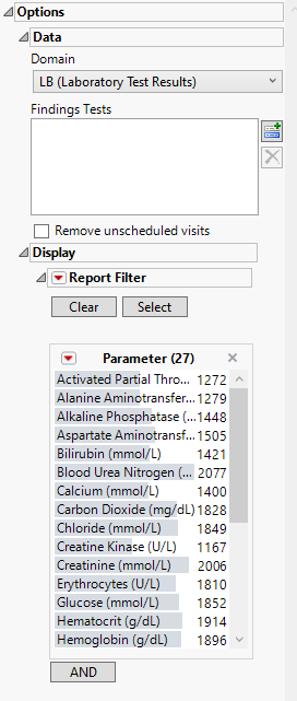

Options
Domain
Use this widget to specify whether to plot the distribution of measurements from either the Electrocardiogram (EG), Laboratory (LB), or Vital Signs (VS) findings domains.
Findings Tests
Use this widget to select Findings Tests for the analysis. The report will autorun and analysis is restricted to the selected tests only.
Remove unscheduled visits
You might or might not want to include unscheduled visits when you are analyzing findings by visit. Check the Remove unscheduled visits to exclude unscheduled visits.
Report Filter
This widget enables you to subset and view subjects based on demographic characteristics and other criteria. By default, the filter in this report enables you to filter by findings tests. Refer to Data Filter for more information on filters.
