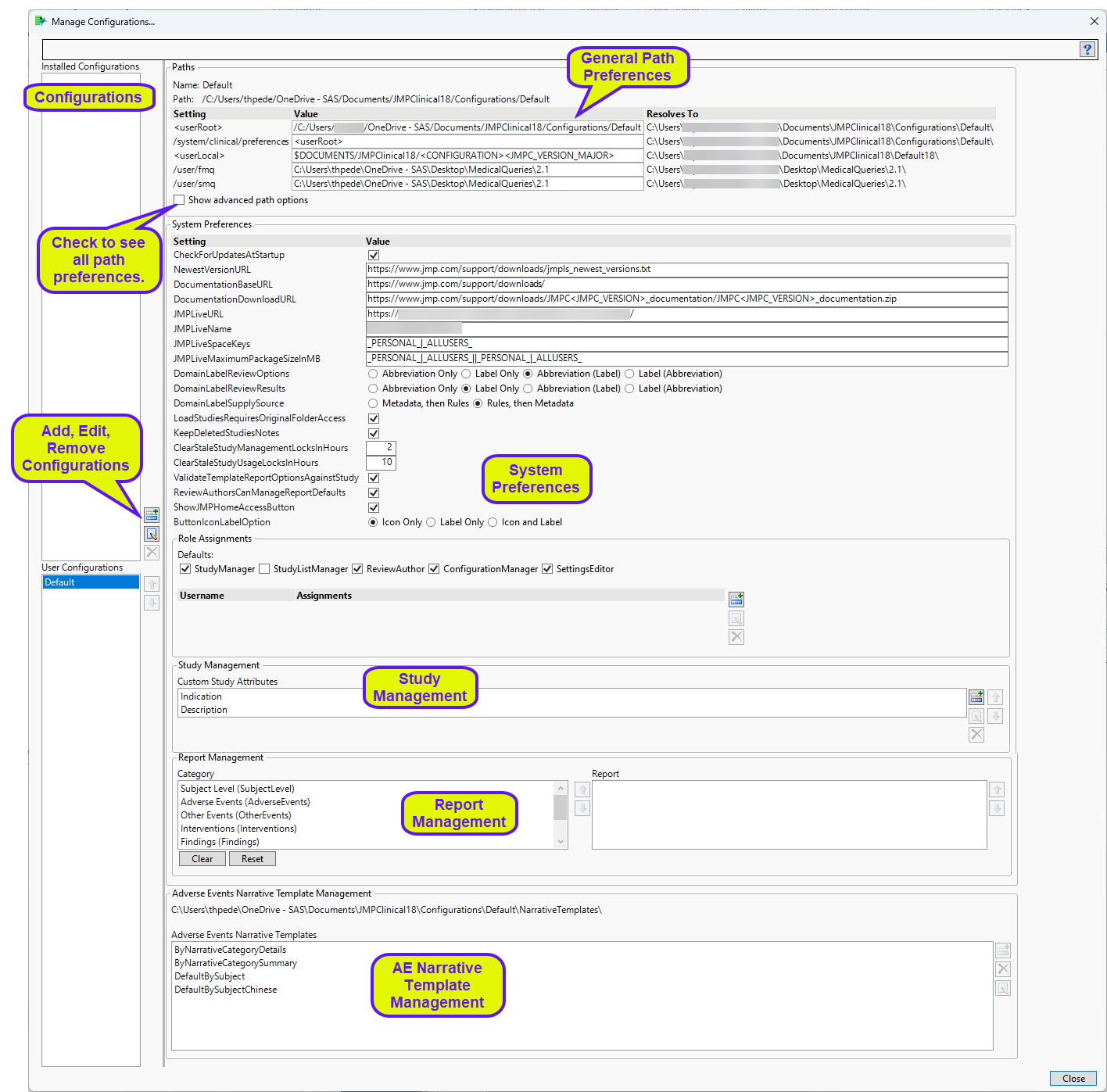

Manage Configurations
The Manage Configurations... window is accessed from the Settings tab of the JMP Clinical Main Window.
8 Click to open the Manage Configurations... window, shown below:

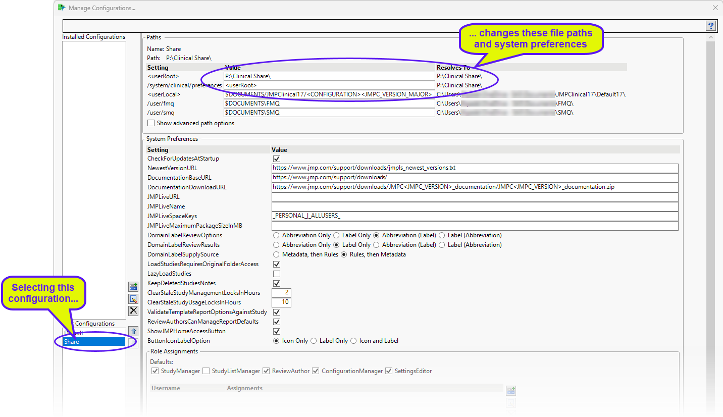

Adding a New Configuration
In this example, we create a new configuration named Share.
Note: You must have a Configuration Manager role assignment and Write privileges to the relevant folders to add a configuration.
Determine the location for your configuration files.
8 If the planned location is on your local machine, navigate to the folder where you want to put your configuration files.
8 If the planned location is on a shared or network drive, use OS commands to map the drive where the new folder is to reside.
In this example, the shared drive is defined as drive U:. Note: Your file path will be different.
8 Create a new folder in the mapped location.
In this case, we will name the folder ClinicalShare. This folder will serve as the root directory for the new shared configuration.
8 Open JMP Clinical and click the Settings tab.
8 Click to open the Manage Configurations... window.
8 Click to open the Add window shown below:
8 Specify a name for your configuration.
In this case, the configuration is named Share.
8 Click to open a Choose Directory window.
8 Navigate into the Clinical Share folder and click .
8 Click the User Configurations radio button.
The Add window appears as shown below:
8 Click .
The new configuration is added to the Manage Configurations window. If you select it, all of the default paths and system preferences are displayed, as shown below:
Note: While all paths and preferences are editable, you should consult your system administrator before making any changes.
8 Click to close the Manage Configurations window.
Note: Anyone with Read and Write privileges on the shared drive has access to a new shared folder. As the creator of this folder you can control level of access by changing the permissions using WinOS commands.

System Preferences for a Configuration
System preferences are specified in the system.clinical.preferences file.
Notes about the system.clinical.preferences File
Note: All preferences are defined in the system.clinical.preferences file. Most users will never need to manually change any of these preferences. You should never open and directly edit the system.clinical.preferences file. Any changes that need to be made can be done in the Manage Configuration... window and should be made only by an experienced System Administrator.
The original syntax for preferences is of the following form:
