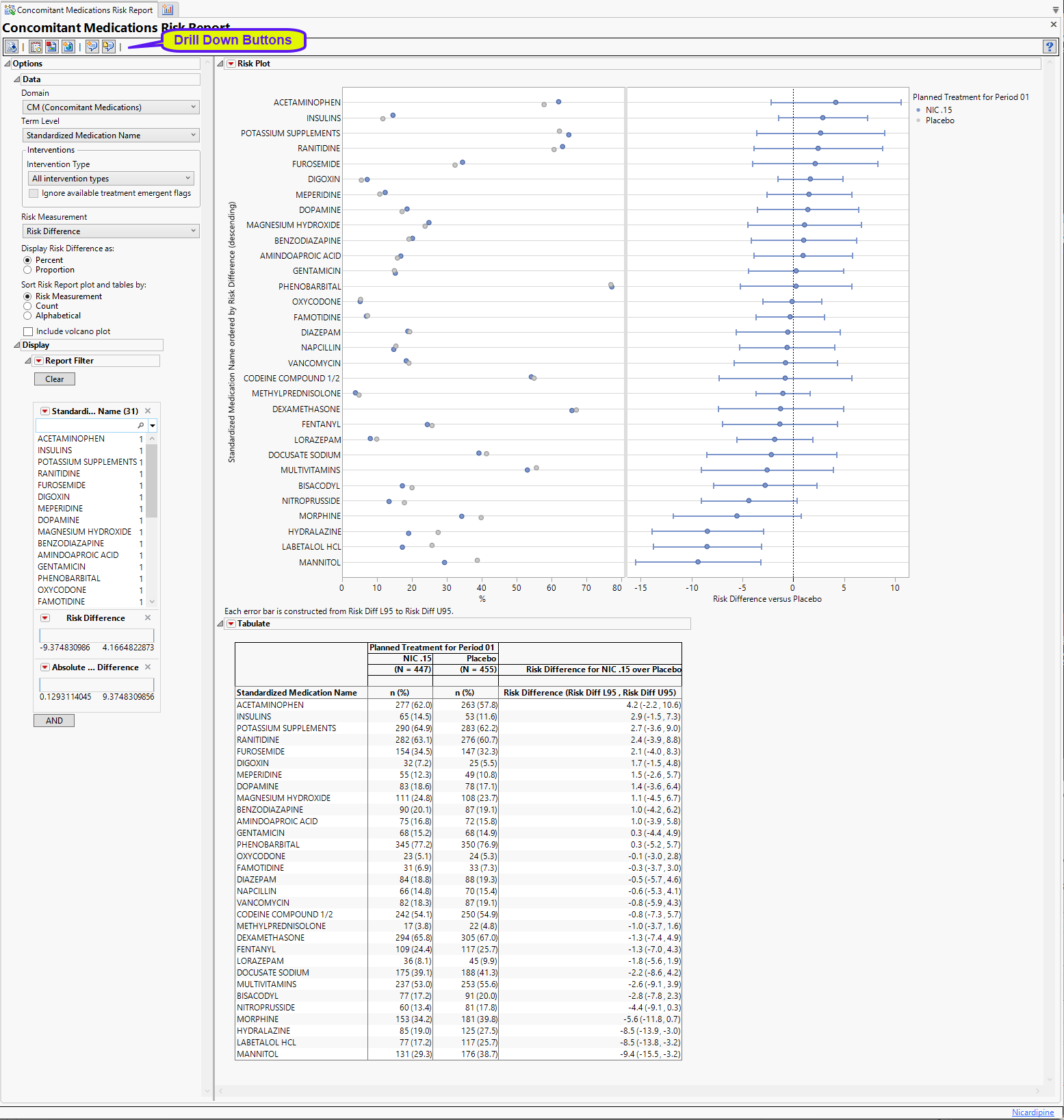

Running this report for Nicardipine using default settings generates the report shown below.

Patients are assessed for each intervention they experience and Percent Occurrence and Risk Difference are calculated for each intervention by treatment group. Percent Occurrence is simply the percentage of patients in a treatment group who experience the intervention at least once during the trial period. Risk difference is calculated by subtracting the number of patients exhibiting the intervention in the control group from the number of patients exhibiting the intervention in the treatment arm. Relative Risk or Odds Ratios may also be calculated.
