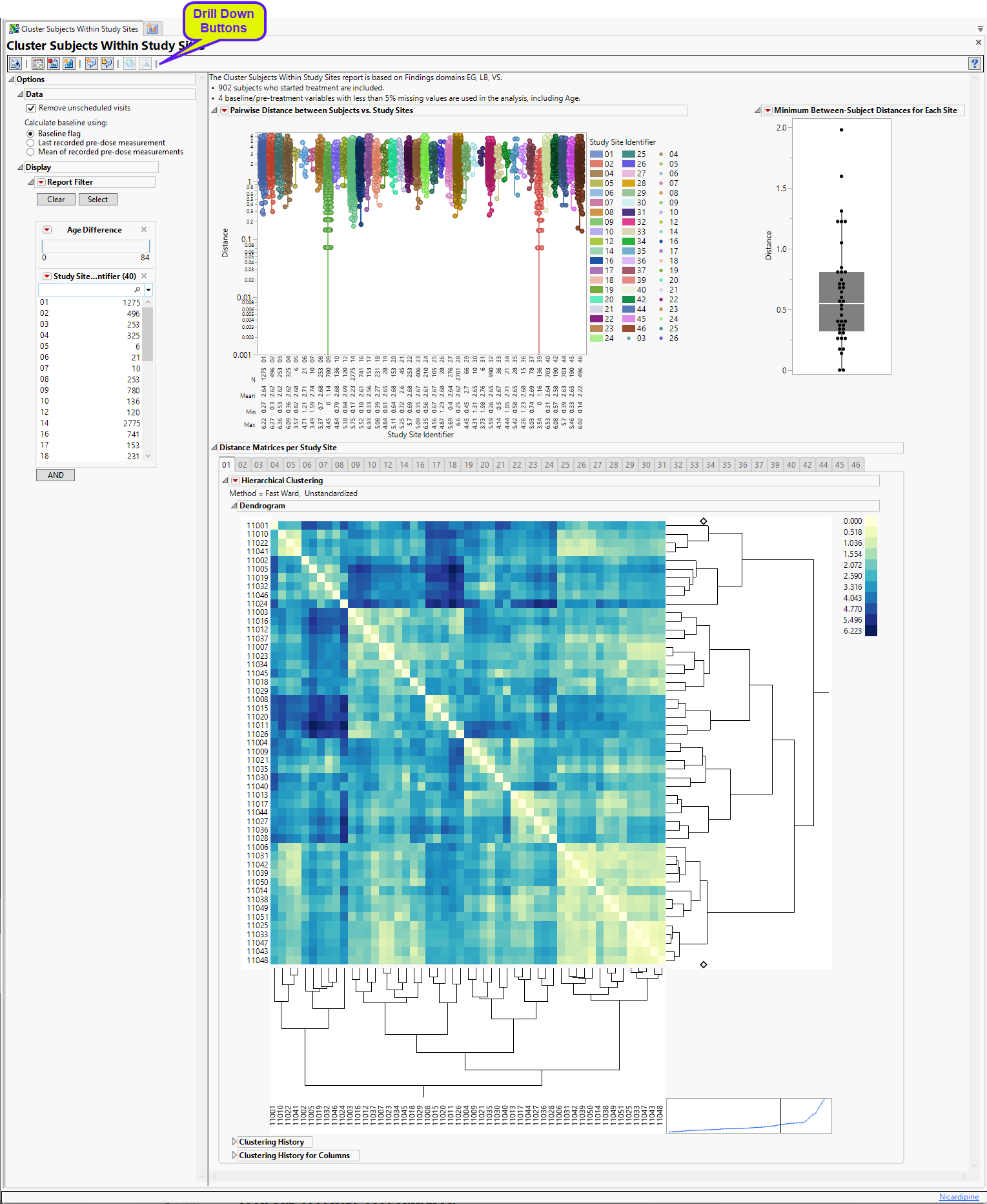

This report clusters subjects within study site for the purpose of identifying similar subjects. It constructs a cross domain data set using as much baseline data as possible (subject to user options). The dataset includes age and the variables from available findings domains (LB, EG, VS, etc.) with less than 5% missing values. Next, it calculates Euclidean distances to compute a distance matrix and performs hierarchical clustering of subjects within each study site. Findings values are averaged by USUBJID, test code, visit number, and time point (if available) if there are multiple measurements for a visit or time point. The goal of this exercise is to identify pairs of subjects with a very small distance. This could be an indication that these subject are slightly modified copies of one another.
Report Results Description
Running this report for Nicardipine using default settings generates the report shown below.
The Cluster Subjects Within Study Sites report shows the results of clustering of the subjects on the basis of different study sites. The results for each grouping are presented in a separate “section”.

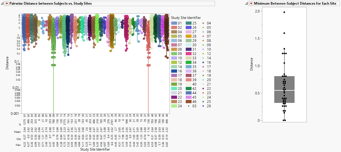

Between-Subject Distance Summary
This section presents box plots of the pairwise Euclidian distances between subjects presented by site and Box Plot of the minimum pairwise distance taken from each site.
It contains the following elements:
• One set of Box Plots of Pairwise Distances between Subjects vs. Study Sites.
This figure shows box plots of all pairwise Euclidian distances within each study site. Individual points are overlaid with the boxplot. The Y-axis is set to log-scale by default for the ease of identifying small distance points when the range of distance is large. A summary table is shown below the boxplot presenting the N, Mean, Min, Max values for each study site. Values closer to zero (0) reflect subjects that are very similar to one another, which could indicate that they are slightly modified copies.
• One Box Plot of Minimum Between-Subject Distances for Each Site.
The box plot of minimum pairwise distances provides some idea of the most similar subjects within each site.

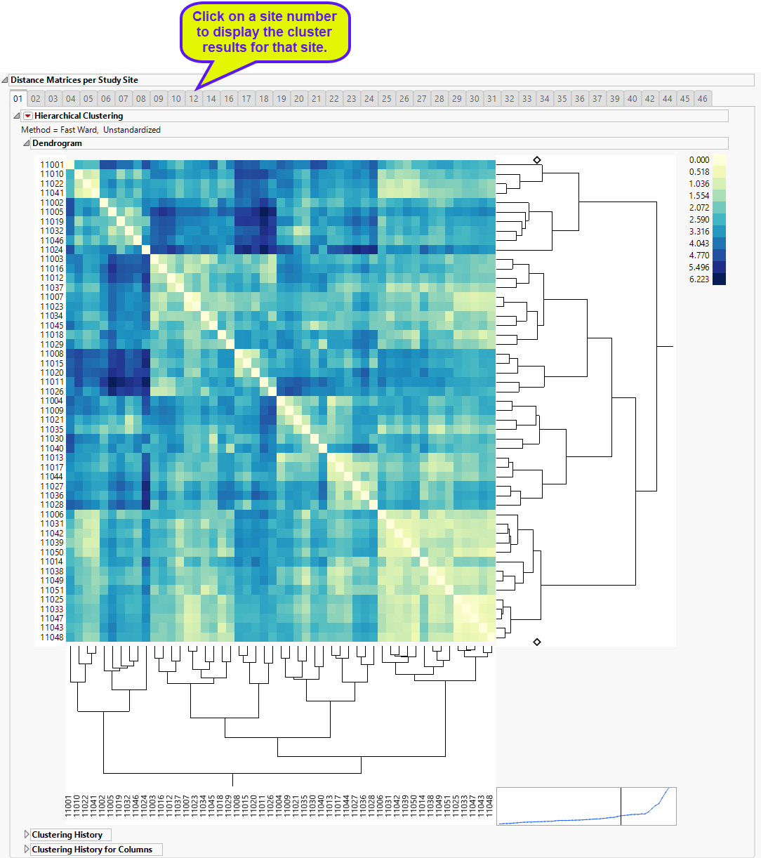

Distance Matrices per Study Site
The Distance Matrices per Study Site section is shown below. There is one panel for each study site in the trial. The panels are named after the study sites' names or IDs.
• One Hierarchical Clustering display that clusters subjects based on the Euclidean distance. A heatmap from Hierarchical Clustering is shown with subject IDs being rows and columns annotations. The legend shows the pairwise distance values with a minimum of zero.
Bluer color indicates subjects that are more similar, whereas yellow shows subjects less similar. The clustering dendrogram is presented to the right of the heat map and can show sets of more than two subjects that are similar to one another. All the pairwise distance matrices, along with the subjects' ID , study sites and treatment arms, are stored in separate jmp tables, and can be accessed by clicking the 'Show Tables' button.

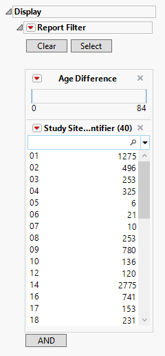

Report Filter
These filters enable you to subset and view subjects based on demographic characteristics (Age Difference), study sites, and other criteria. Refer to Data Filter for more information.
