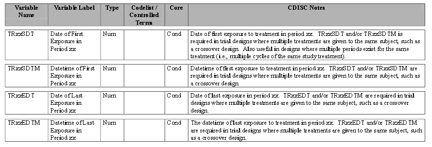

• Timing Variables (TRxxSDT or TRxxSDTM) and (TRxxEDT or TRxxEDTM): Dates or Date/Times in numeric format indicating the start and end dates respectively for each treatment period xx.
Refer to the ADaM Implementation Guide for additional information.

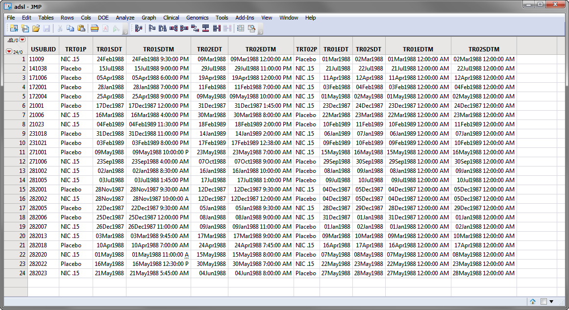

Currently crossover support is automatically detected and used if multiple TRTxxP or TRTxxA variables exist and the associated timing variables for the xx period exist and contain values. Those values might look like the values in the Nicardipine Crossover sample data set, shown below.
Note: For clarity, the majority of the adsl.sas7bdat columns in the screen shot below above have been hidden using the Cols > Hide/Unhide command.
Note: You can override crossover detection by specifying either Specified Below or None as the Treatment or Comparison Variable to Use.
In the screen shot of adsl.sas7bdat, shown above, the SAS variable names are shown. During the report analysis, when adsl.sas7bdat is merged into the relevant analysis domain (for example, AE, LB, VS), the adsl treatment timing variables are compared to the timing variable in the domain and new variables: Treatment, Period, and Treatment (Period) are created. The values for these variables are assigned based on the value of the TRTxxP or TRTxxA and the value of the xx in the variable name when the start date of the domain record falls within the treatment period dates.

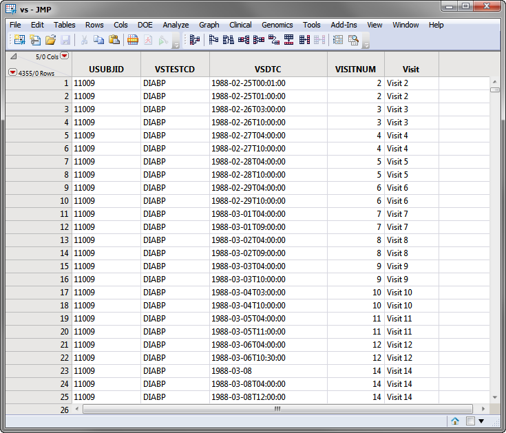

The SDTM data records for a subject can appear as shown in the portion of the VS domain (vs.sas7bdat (SAS names are being shown)) for the Nicardipine Crossover sample data set, shown below.
Note: For clarity, some of the vs.sas7bdat columns in the screen shot below above have been hidden using the Cols > Hide/Unhide command.
Based on comparison of the VSDTC date/time (note that SDTM follows the ISO 8601 date/time standard) with the ADSL timing date/time (numeric SAS date format), the subject records are assigned to the first treatment for Visits 1-6 and the second treatment period for Visits 7-14.

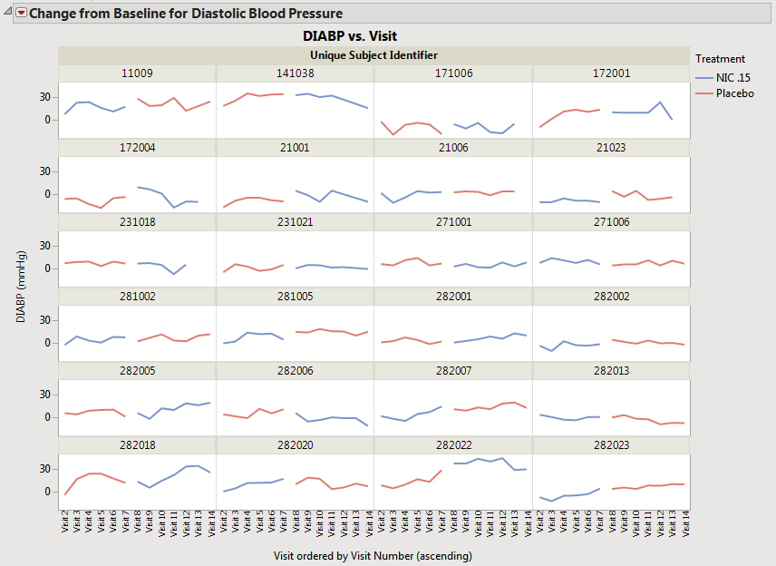

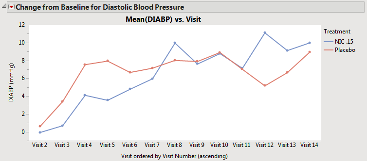

• When neither the Overlay visits when treatment crossover is detected box nor the Pool subjects in average time trend plots when treatment crossover is detected box is checked, the average time trends view has one connected line representing the average for that treatment across all periods (assuming that the treatment value is coded with the same value across periods). Treatment values that changed across treatment periods still have separate lines at the moment of crossover (shown below). Note that in this case, this does not change the composition of the subjects used for calculating the means.

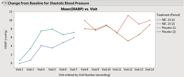

• When the Pool subjects in average time trend plots when treatment crossover is detected box is checked, but the Overlay visits when treatment crossover is detected box is not checked, the subjects that have the same value for treatment across different periods are pooled to calculate the average trend across the visit(s). For example, subjects assigned to Placebo on period 1 are pooled with subjects assigned to Placebo on period 2, and only one line is displayed for Placebo, as shown below.
Note: When the Pool subjects in average time trend plots when treatment crossover is detected box is not checked but the Overlay visits when treatment crossover is detected box is checked, two separate lines would be drawn for Placebo (1) and Placebo (2) (not shown).
• When Subject-level Time Trends Results are generated (occurs when the Plot average time trends across treatment groups bow is unchecked), the results are same regardless of whether the Pool subjects in average time trend plots when treatment crossover is detected option is checked or not.

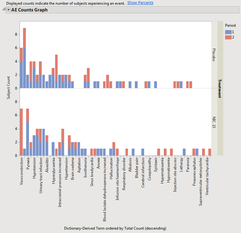

When a crossover study is detected, the distribution results automatically categorizes adverse events by treatment period beginning with JMP Clinical version 5.0.
The results with the example Nicardipine crossover data are shown below.
This view is similar for Interventions and other Events domains for distributions.
