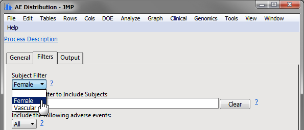

Three parameters, Select saved subject filter, Additional Filter to Include Subjects and Select the population to include in the analysis, are used to specify a domain filter.
Available options are described in the following table:
Option:
Select when you want to use a:
• Data set containing USUBJID values of subject to include in analysis. These data sets can be created from most of the JMP Clinical reports.
• General user-customized condition (enter Sex = "F" to include only females in the analysis, for example).
• A percent calculation is then only generated based on demographic variable groups for subjects meeting the filtering criteria.

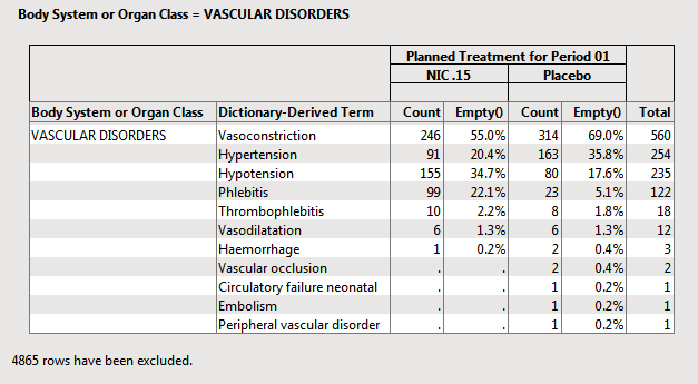

The subject counts for each value of relevant demographic variables (Treatment, SEX, RACE, COUNTRY, SITEID, STUDYID (if not constant) are computed and then the reciprocal of the subject count is recorded in the DM or ADSL data set for merging into AE. This value can be used as a frequency weight for each subject that has a specific event to calculate the percent of subjects for that given demographic group that experience the AE.
The following example uses the Nicardipine data included with JMP Clinical.
In this example:
• 455 subjects were on Placebo.
• The reciprocal 1/455 = .00219. This value can be used for each subject that has an AE to compute the percentage.
• 314 subject on placebo experience Vasoconstriction.
• 314 x 1/455 = 314/455 = .6901 or 69.0% of subjects on placebo experienced Vasoconstriction.

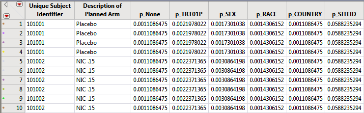

These reciprocal or frequency variables based on the demographic variable counts for each subject are computed and used when merged into the AE records table to compute percentages.
These columns are used in the distribution results dashboard to dynamically calculate percentages. Further examples are given when describing the dashboard results.

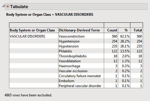

Overall Subject Percent Occurrence for Each Event
This step is performed only when a unique occurrence of an event is counted (based on above check box option). This is total percent of subjects experiencing an event, calculated for each event.
For example, in the Nicardipine data , 560 of the 902 subjects in the safety population experienced vasoconstriction.
• 560/902 = 0.621 or 62.1% of all subjects had a vasoconstriction event, regardless of treatment.

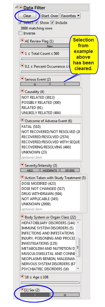

• A Data Filter with several default variables to filter/subject the report view.

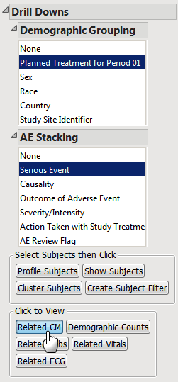

• Column Switchers: Choose the grouping variable used as the demographic comparison for the counts plot and table and a stacking variable to categorize events/interventions (especially useful with adverse events).
• Profile Subjects: Generates Patient Profiles for subjects experiencing selected events.
• Show Subjects: Subsets and opens ADSL (or DM, if ADSL is unavailable) for subjects experiencing selected events. A Table of USUBJIDs is also presented.
• Cluster Subjects: Clusters subjects experiencing selected events based on available covariates.

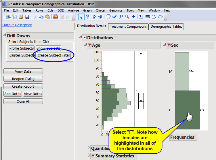

• Create Subject Filter: Creates a data set of USUBJIDs for subjects experiencing selected events, which subsets all subsequently run reports to those selected individuals. The currently available filter data set can be applied by selecting the Subject Filter data set in any report dialog on the Filters tab.

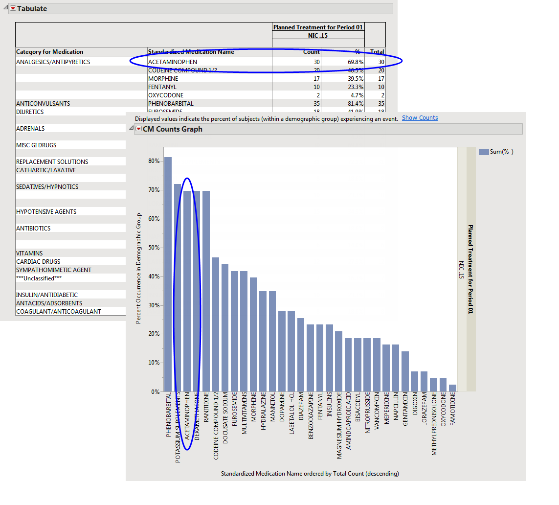

• Related CM (AE/Events Distribution only): For subjects experiencing selected events, this action button launches Interventions Distribution to summarize the distribution of concomitant medications (CM).
• Demographic Counts: For subjects experiencing selected events, this action button generates a stacked Histogram to show subjects across study sites by Trial Time Windows.
• Related Labs: For subjects experiencing selected events, this action button launches Findings Time Trends to summarize laboratory results (LB) across time.
• Related Vitals: For subjects experiencing selected events, this action button launches Findings Time Trends to summarize vitals signs (VS) across time.
• Related ECG: For subjects experiencing selected events, this action button launches Findings Time Trends to summarize ECG measurements (EG) across time.

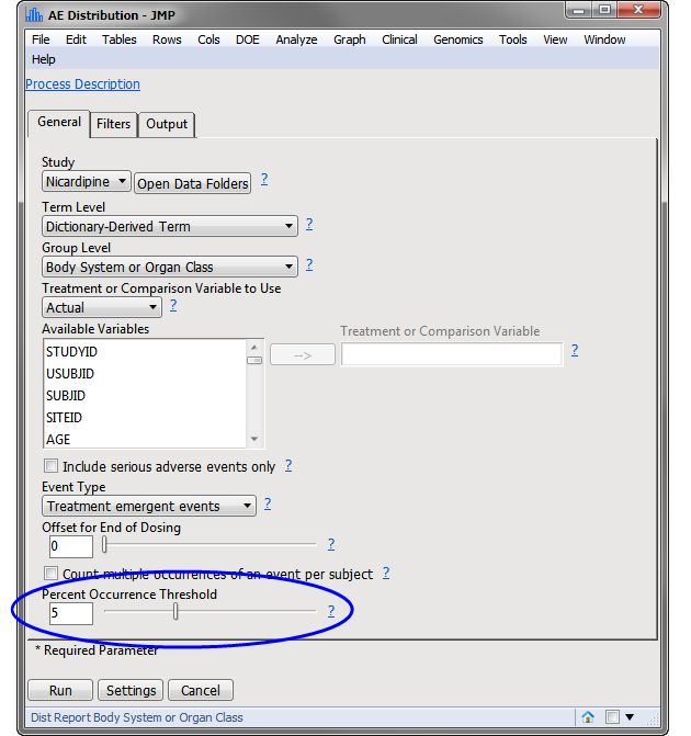

8 Open Adverse Events Distribution.
8 Make sure the first tab on the report appears as shown below:

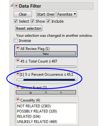

Note: The most significant change made in this example is that the Percent Occurrence Threshold has been adjusted from 0 to 5 (circled above).
8 Click .

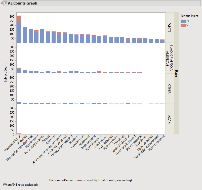

The counts (Y axis) represent the count of subjects that experienced the given event term (X axis); the counts are categorized as stacked bar charts for levels of Severity/Intensity (AESEV). This categorization is a result of choosing that variable from the AE Stacking action button.
When a unique occurrence is counted only for each subject/event, the percent of subjects experiencing an event within any of the available demographic grouping variables is calculated interactively by the report. The plot below was generated by clicking Show Percents (circled above).

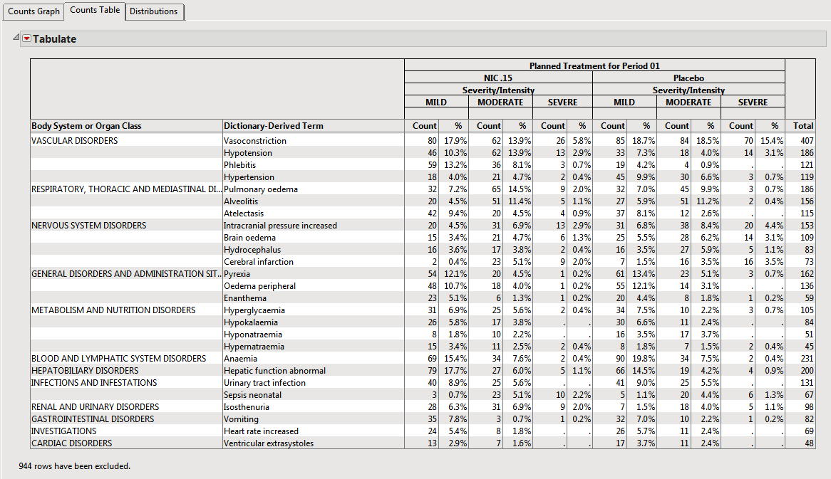

The counts table (shown below) reflects the same counts/percentages as shown in the counts plot in tabular form. The Grouping and Stacking column from the down panel drive the format and detail in this table. This flexibility enables you to create several tables for summarizing events from one report.

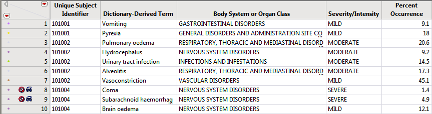

The output STUDY_aed_xx.sas7bdat data set used to generate these plots and tables contains a row for each subject experiencing each event (optionally by treatment period in a crossover scenario).
Rows that do not meet the Percent Occurrence Threshold specified on the dialog (5% in this example) are hidden and excluded from analysis. This filter can be interactively changed using the Data Filter option for Percent Occurrence (circled below).

Example 1: Using the action buttons on the Output dashboard, select None for Demographic Grouping and None for AE Stacking and examine the Counts Table tab.
407/902 = .451 45.1% of subjects experienced (treatment emergent) vasoconstriction
Example 2: Using the action button on the Output dashboard, select Planned Treatment for Period 1 for Demographic Grouping and None for AE Stacking and examine the Counts Table tab. Note how the values change.
168/447 = .376 37.6% of subjects on NIC .15 experienced vasoconstriction
239/455 = .525 52.5% of subjects on Placebo experienced vasoconstriction
Example 3: Using the action button on the Output dashboard, select Planned Treatment for Period 1 for Demographic Grouping and Severity/Intensity for AE Stacking and examine the Counts Table tab. Note how the values change.
80/447 = 17.9% of subjects on NIC .15 experienced MILD vasoconstriction
62/447 = 13.9% of subjects on NIC .15 experienced MODERATE vasoconstriction
26/447 = 5.8% of subjects on NIC .15 experienced SEVERE vasoconstriction

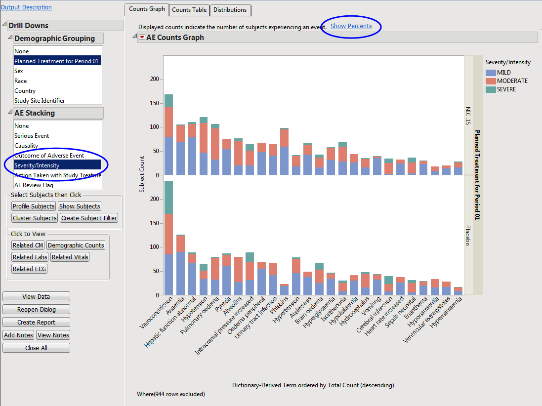

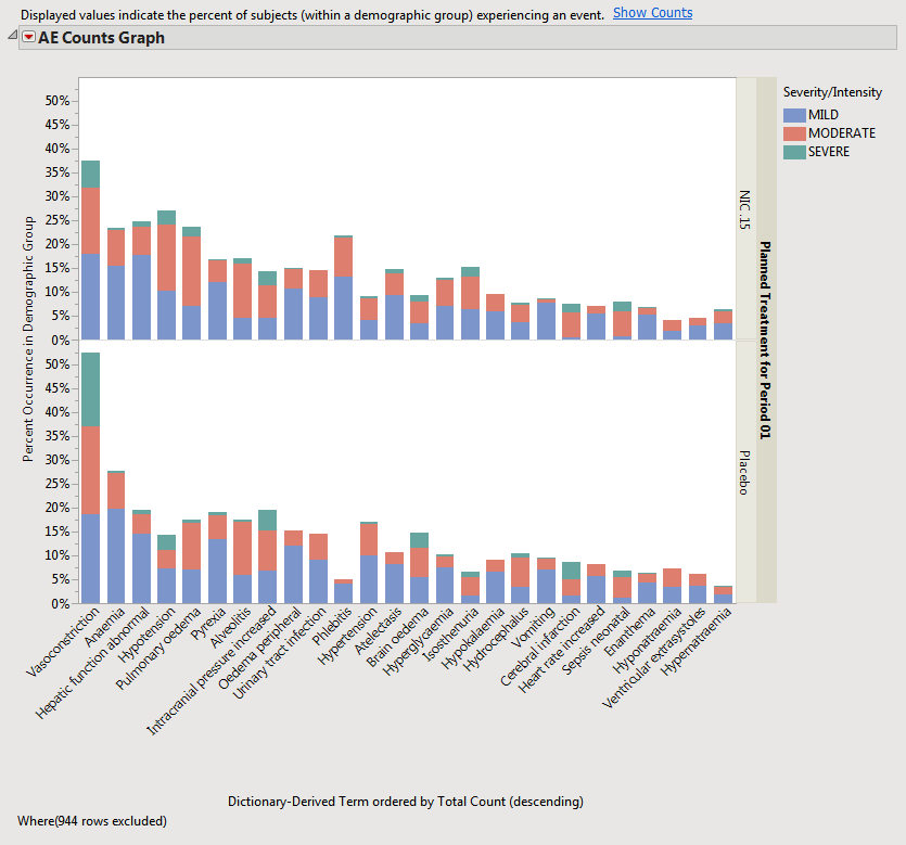

85/455= 18.7% of subjects on Placebo experienced MILD vasoconstriction
85/455= 18.5% of subjects on Placebo experienced MODERATE vasoconstriction
70/455= 15.4% of subjects on Placebo experienced SEVERE vasoconstriction

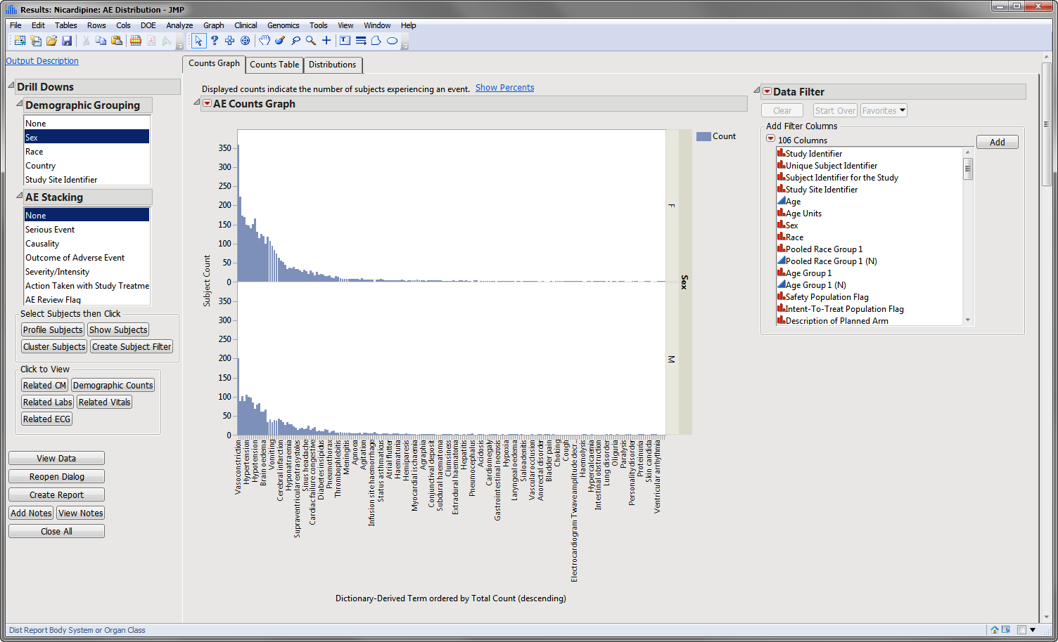

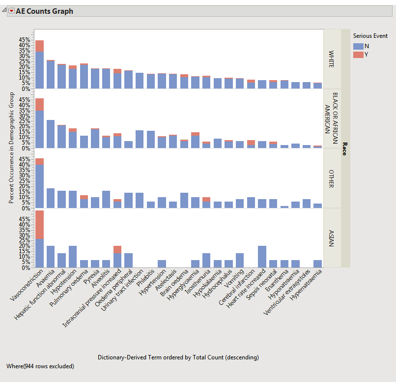

Note: In the example, the demographic group column changes the percent calculations (also known as changes the value of the denominator used in the formula), while the stacking/categorization variable just partitions the counts and percentages.
The value of percent calculation comparison can be seen clearly in the two plots shown below. The first plot shows the AE Counts graph grouped by RACE and categorized by Serious Event.
This plot can be misleading because of the large differences in the respective number of subjects in each RACE category. In this case, comparing the percentages might be more informative.
8 Click Show Percents (located above the plot and circled below).
The resulting plot (below) then is much more useful for making comparisons.

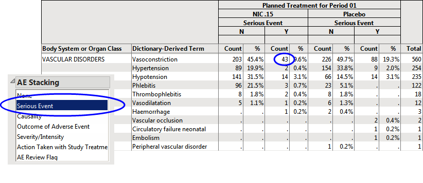

Percent Calculations When an Interactive Data Filter Is Applied.
When you use the Data Filter (located on the right side of the report) to filter the records that are shown, the change does NOT affect the demographic group denominator values that are used in the percent calculations. These denominators, as described previously, are derived in the SAS programming of the analysis based on the analysis population. The counts (the numerator in the percent formula) of subjects experiencing the event (and now meeting the data filter criteria) change values to reflect the use of the data filter.
In the following example, the default (Event Type = All) Adverse Events Distribution report was run for the Nicardipine sample data and the results were subsequently filtered for Serious Event = Y, as shown below:
The results are shown below:
88/455 = 19.3% of subjects on Placebo experienced serious vasoconstriction.
If the Data Filter selection is based on a demographic variable, care must be taken to interpret the results.
In the following example, Sex = F has been selected in the data filter:
Note: You must click (circled above) to clear out prior filters before making a new selection.
206/455 = 45.3% of subjects on Placebo were females with vasoconstriction.

For example, on the Adverse Events Distribution dialog, you can:
Example 1: Generate a Select saved subject filter of only females:
8 Run Demographics Distribution Report.
8 Select F category in SEX distribution bar chart (or from the data filter). Note how the females are highlighted in all of the distributions.
8 Click the action button (circled above).
8 Name the filter.

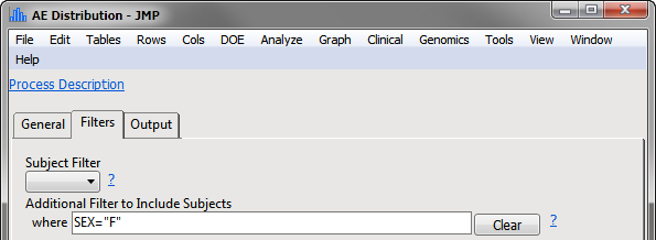

8 Specify this filter as a Select saved subject filter in the AE Distribution dialog
8 Click .
Example 2: Specify an Additional Filter to Include Subjects
When filtering is applied up front, the percent values and their interpretation are based on females only:
There are 297 females on Placebo.
206/297 = 69.4% of female subjects on Placebo experienced Vasoconstriction.

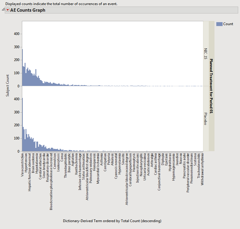

Distribution Results When Counting Multiple Occurrences of an Event or Intervention
The percent calculations are performed only when a unique event/intervention is counted for each subject in the analysis. If you check the Count multiple occurrences of an event per subject (or Count multiple occurrences of an intervention per subject when running the Interventions Distribution), all records are counted in the results report.
With this option specified, percent values are not computed and the Percent Occurrence Threshold is ignored since the counts of events no longer represent counts of subjects.
Results for the Nicardipine example study when Adverse Events Distribution was run for multiple occurrences of events are shown below.
Note: It might be useful to customize the results report data filter to include the computed Total Count column if you want to filter to more commonly occurring adverse events. The grouping and stacking capabilities and action buttons are still available with this view of the report.
The counts now might represent multiple occurrences of the same event for the same subject. For example, when a unique occurrence only was counted (for all Event Types) in Nicardipine, there was a total of 560 subjects experiencing Vasoconstriction.
However, when all events (including multiple occurrences) are counted, there were 693 records of occurrence of Vasoconstriction across the subjects on the study.
The distinction in the interpretation of the counts is reflected in the text field above the plots on the Counts Graph tab.
When the check box is NOT checked (default behavior), the following text (circled) is shown:
When the check box is checked, the following text (circled) is shown:

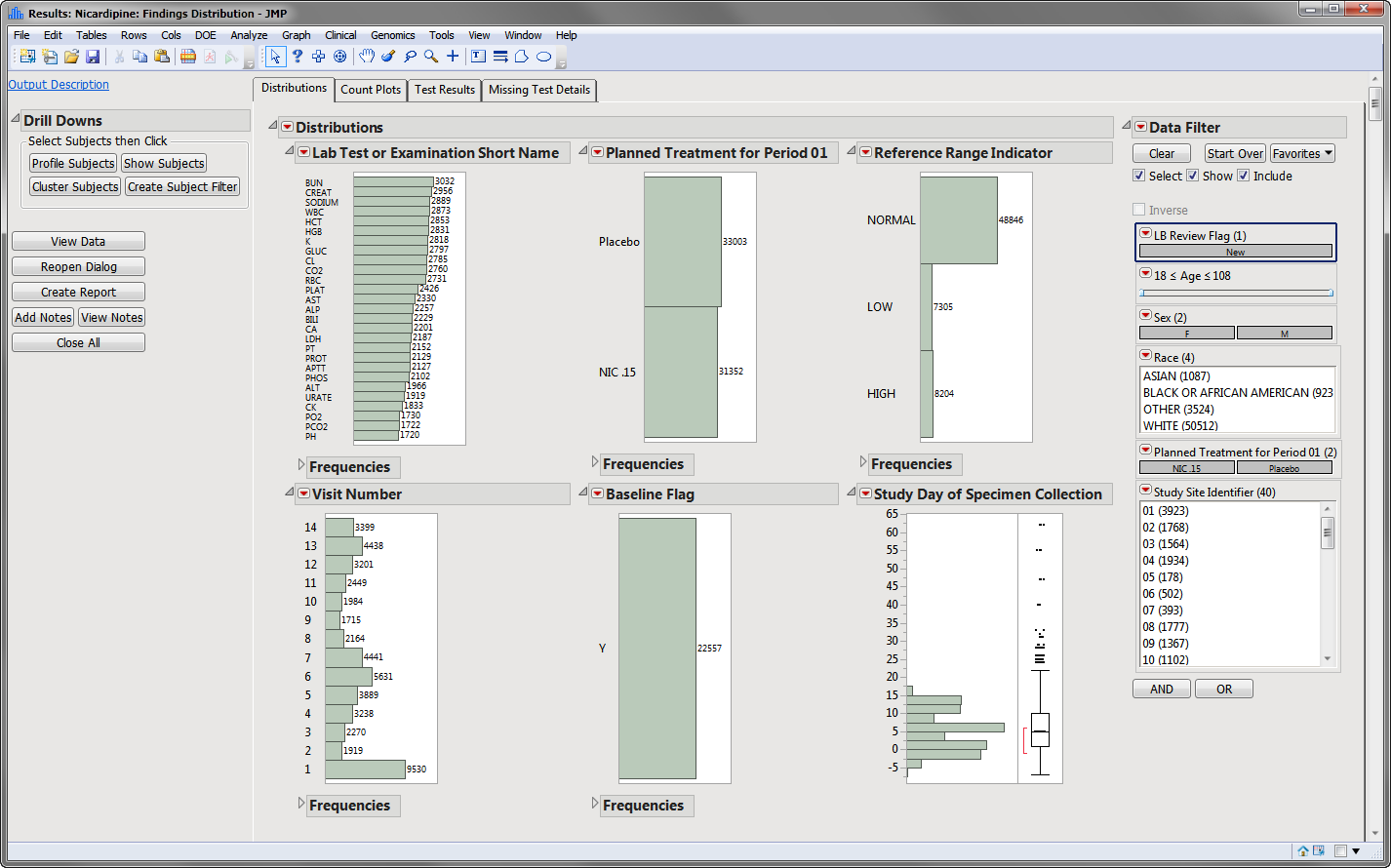

All distributions ( Adverse Events Distribution, Events Distribution, Interventions Distribution, and Findings Distribution) also include a set of distributions of relevant results variables in the report.
For the Findings Distribution report, these distributions are the initial view. The findings calculations follow the same workflow as described by the events computation, but are simpler because no percent calculations are performed. Most of the analyses are derived using the JMP reports.
Findings Distributions Results
The Findings Distribution report might contain the following results:
• Distributions: Contains distributions of parameters from the specified Findings domain.
• Count Plots: Contains graphs for each test to display measurement counts within categories of the Reference Range Indicator variable. This tab is displayed only if the xxNRIND variable is present in the Findings domain data (typically the LB domain).

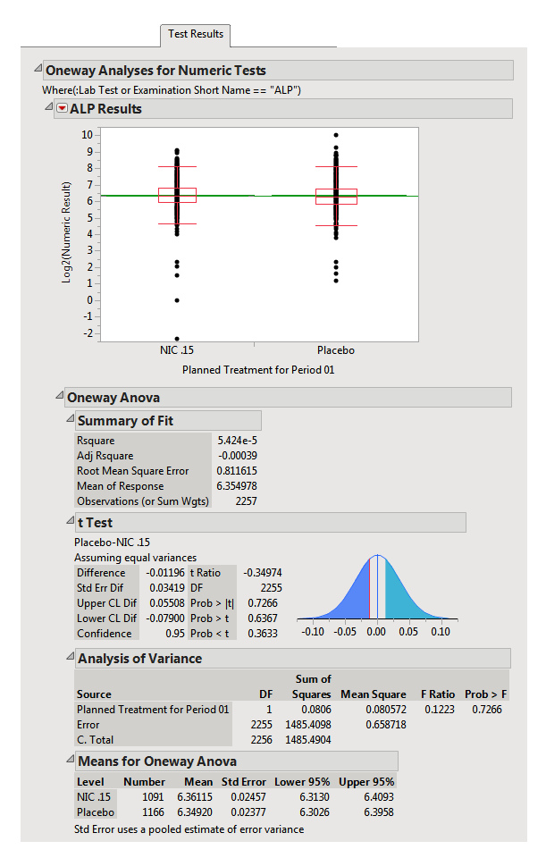

• Test Results: Contains One-way Analyses (ANOVA) for each test that has numeric measurement results (xxSTRESN values), Contingency Analyses for each Findings test that has character results (xxSTRESC values but missing xxSTRESN values), or both.
• Missing Test Details: Contains tables displaying subject counts for tests that were either not recorded, or that were recorded but have missing measurement values (of xxSTRESN and/or xxSTRESC). If all subjects had nonmissing recorded test measurements for all tests, this tab is not shown.
The Distribution tab is shown above. The other three tabs are shown below:

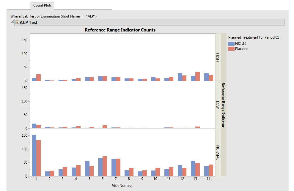

Count Plots: This plot shows counts of records from the Findings domain by Study Visits. The xxNRIND and either the VISIT or VISITNUM variables are required in the domain in order to produce these plots.
Test Results: This report section displays either an ANOVA (numeric tests) or a Contingency analysis (character findings) comparing findings measurement values across treatment or comparison variable for each test in the domain. In the example setting, there are no character test findings, so the contingency analysis is not shown here.

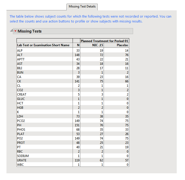

Missing Test Details; This tab tracks both missing tests and test records that contain missing values.
On this tab, there are possibly two tables that can be reported to track these types of missing test details.
• A Missing Tests Table.
This table displays subject counts for which Findings tests were either not reported or not recorded. For example, the number of subjects for whom no record was taken for the ALT lab test in the LB domain is displayed in this table for the ALT test row.
• A Missing Tests Results Table.
This table displays subject counts for any Findings test was that was recorded, but has a missing measurement value (missing an xxSTRESN value for numeric tests or missing an xxSTRESC for categorical tests). This table differs from the Missing Tests Table in that a record was reported for the test for that subject, but the measurement value was missing.
You can select the numbers in these tables and use action buttons to drill down to see profiles or lists of subjects that have missing records or missing measurement values. The Nicardipine results of counts of subjects for whom the tests were not recorded is shown.
