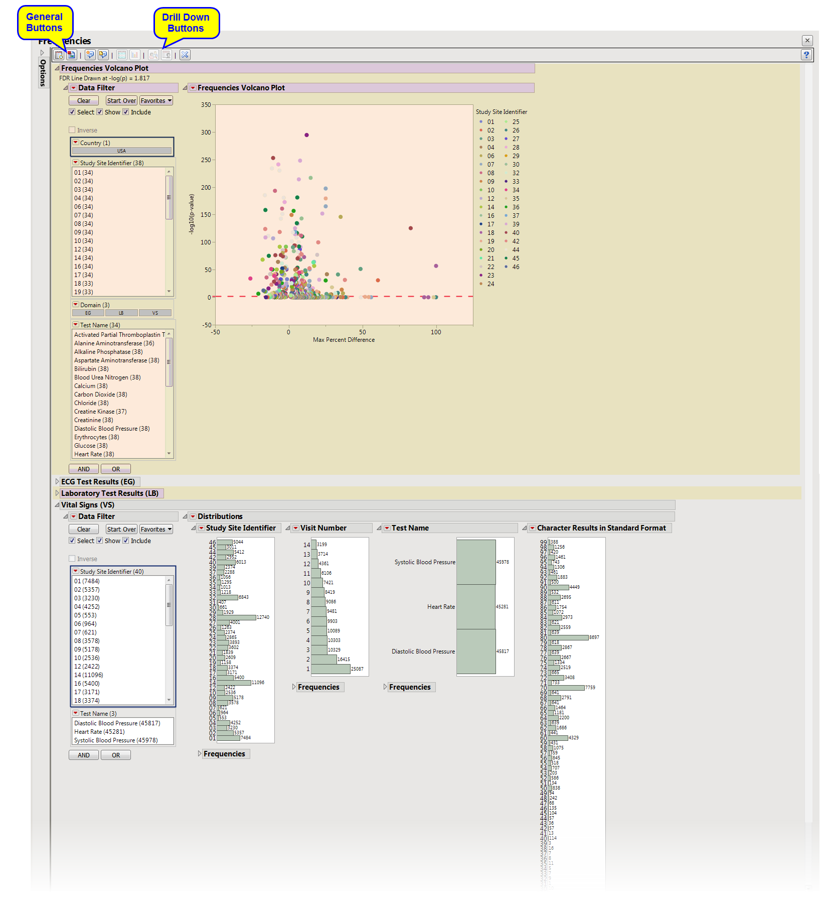

Frequencies Volcano Plot
Shows a volcano plot used to determine the deviation of the proportion of findings frequencies at each site with the overall proportions for the findings across the whole study.
• One Data Filter.
Enables you to subset subjects based on country of origin, study site and/or Test. Refer to Data Filter for more information.
• One Volcano Plot.
The volcano plot is used to determine the deviation of the proportion of findings frequencies at each site with the overall proportions for the findings across the whole study. Each “bubble” represents a single Findings test for a specific site, which is compared to a reference (all other sites).The X axis represents the maximum difference in proportions between each value of the Findings test between the site and the reference set (all other sites).
You can mouse over points of interest to see their labels or select points by dragging a mouse rectangle over them (as shown above). Selected rows are highlighted in other plots and you can also then click on various Down Buttons for further analyses on those specific sites. For example, if you click , the following opens with comparisons of sites 18 and 40 with all sites not site 18 or 40, respectively.

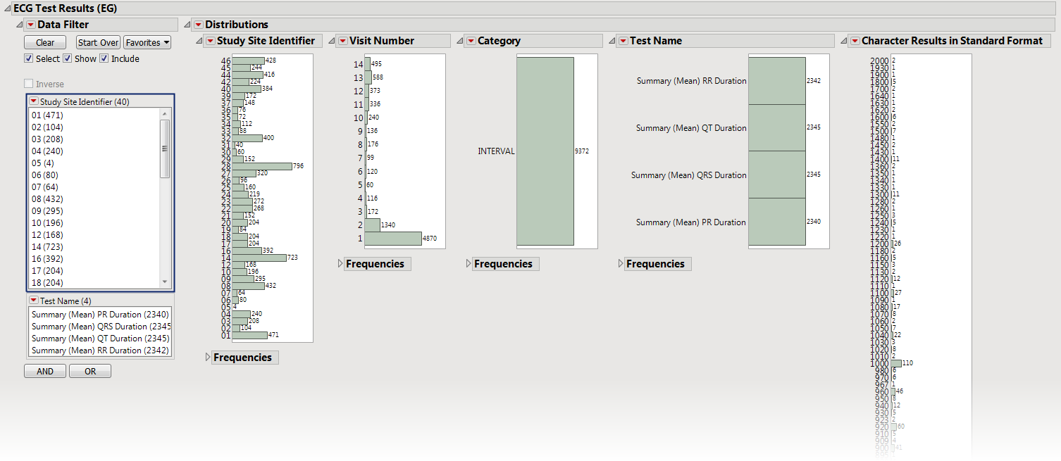

ECG Test Results
Displays histograms summarizing ECG findings across the study.
This section contains the following elements.
• Data Filter: Enables you to filter data based on study site and country.
• Distributions: Displays histograms showing distribution of ECG findings across study sites, tests, and visit numbers, study sites, categories, and tests.

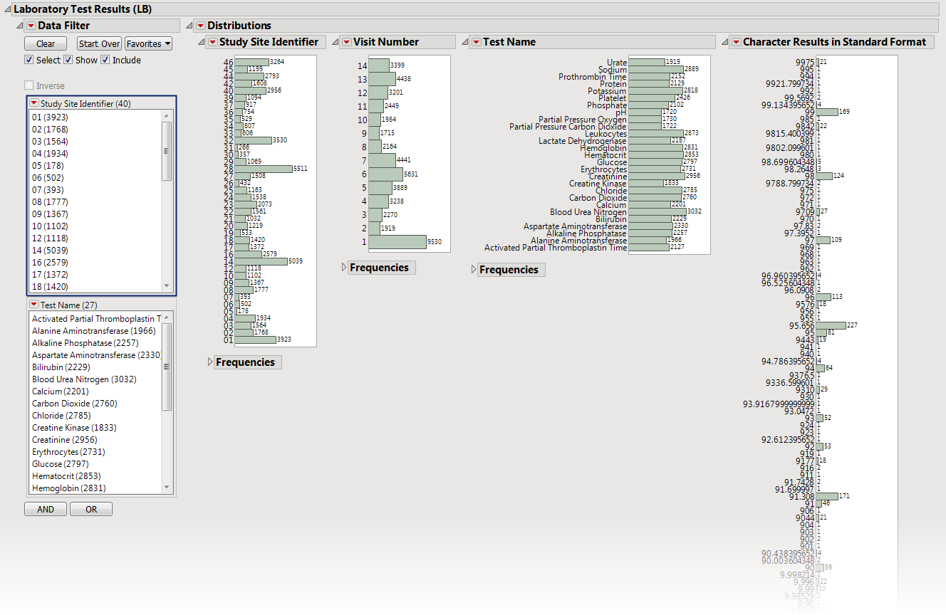

Laboratory Test Results
Displays histograms summarizing lab test findings across the study.
• Distributions: Displays histograms showing distributions of laboratory test findings across study sites, tests, and visit numbers, and tests.

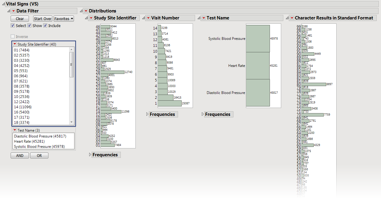

Vital Signs
Displays histograms summarizing vital signs findings across the study.
• Distributions: Displays histograms showing distribution of vital signs findings across study sites, tests, and visit numbers,

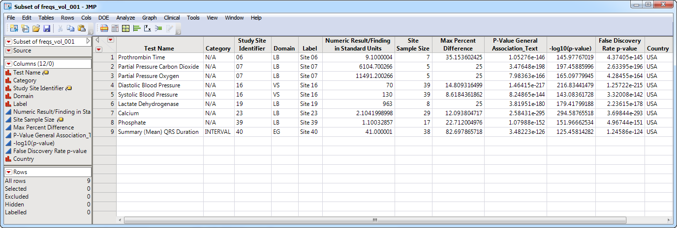

• Show Sites: Shows the rows of the data table for the selected points from the volcano plot. Clicking opens the following table:

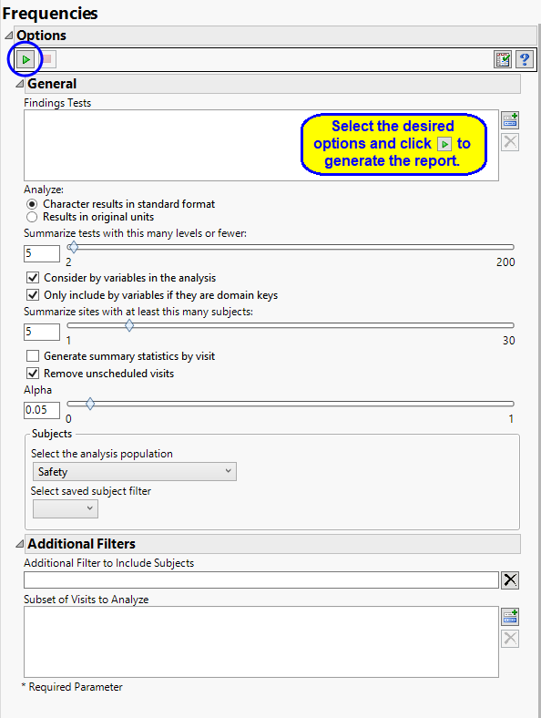

Report Options
Findings Analysis
By default the report is set to analyze all tests from all findings domains. You can opt however, to restrict the search to specific Findings Tests.
You can specify whether to search all results in original units when you Analyze: the data or restrict the search to either character results (in standard format) or numeric results (in standard units).
Use the Summarize tests with this many levels or fewer: option to specify the maximum number of distinct levels or values a findings test may have to be included in the analysis (a findings test must have at least 2 levels). The number of levels is determined based on the selected variable of analysis.
You can opt to Consider BY variables in the analysis. This option, which assumes that BY variables (left vs. right arm for collecting blood pressure data, for example) are included in the experimental design, is selected by default. You can uncheck this option to ignore BY variables.
Use the Only include BY variables if they are domain keys option to subset the available variables to only include those variables that are domain keys. If the option is unchecked, the report uses the cross-classification of xxCAT, xxSCAT, xxLOC, xxMETHOD, xxPOS, xxSPEC, and xxTPT for creating by groups for all variables that are available (as it had in the past).
The Summarize sites with at least this many subjects: option enables you to set a minimal threshold for the sites to be analyzed. Only those sites which exceed the specified number of subjects are included. This feature is useful because it enables you to exclude smaller sites, where small differences due to random events are more likely to appear more significant than they truly are. In larger sites, observed differences from expected attendance due to random events are more likely to be significant because any deviations due to random events are less likely to be observed.
Selecting the Generate summary statistics by visit option enables you to summarize the specified findings from the sites that meet the specified criteria.
You might or might not want to include unscheduled visits when you are analyzing findings by visit. Check the Remove unscheduled visits to exclude unscheduled visits.
The Alpha option is used to specify the significance level by which to judge the validity of the model generated by this report. By definition, alpha represents the probability that you will reject the null hypothesis when the null is, in fact, true. Alpha can be set to any number between 0 and 1, but is most typically set at 0.01, 0.05, or 0.10. The higher the alpha, the lower your confidence that the results you observe are correct.
